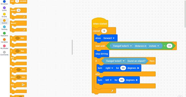

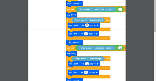

This account is too new to upload attachments to this forum, so we’ve attached an Imgur link with the first part of the code.
The rest of the code after the screenshot is just repeating, following a maze path.
We think the code should work but here it is for reference.
thanks again, Hudson

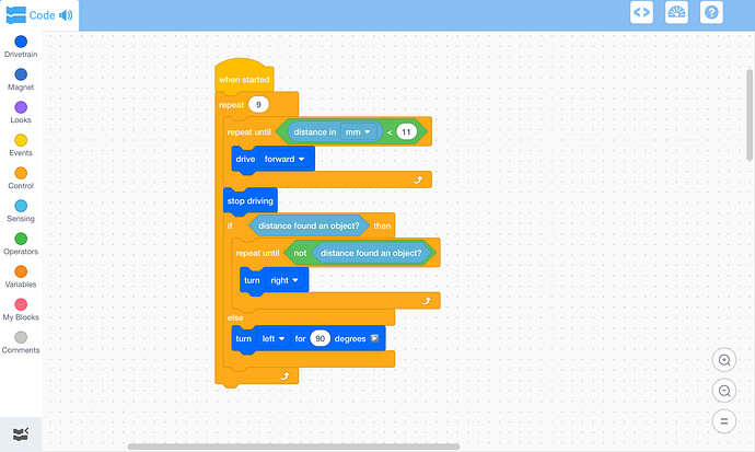

Okay, so you need the drive forward in a loop because it stops instantly, why it stops instantly is because it goes from the drive forward to the wait until, try using a repeat until block with the drive forward in it.
do you mean like this??
another imgur link ^^^
I don’t have access to a computer right now so I can’t show it. but you need to put the drive forward in a repeat until and get rid of the wait untils, then in the requirements put the rangefinder < 11 .
ohhhh okay, well try uploading it to the brain like that and see if it runs.

we tried doing what you said but after hitting run it didn’t move at all
just to be clear what should be the first block under the start tag? and should we have “when autonomous” or “when started”?
Do when started and have the repeat 9 times, then do a repeat until with the drive forward in it, then exit the repeat until and continue the code, and get rid of the wait untils.
Put a stop driving after the second repeat until.
this code looks very different from our first draft, are you sure this code will complete the same function? the code written was specified for a specific maze, just want to be sure it all does the same stuff.
Oh, yes it will, except just ignore the second repeat until and just put the turn right for 90.
ok that’s perfect!! we will have to run the code next week as everything is at our school, but thank you for all of the help, it really has been appreciated!
tried running the code and it did exactly what we needed!!!
