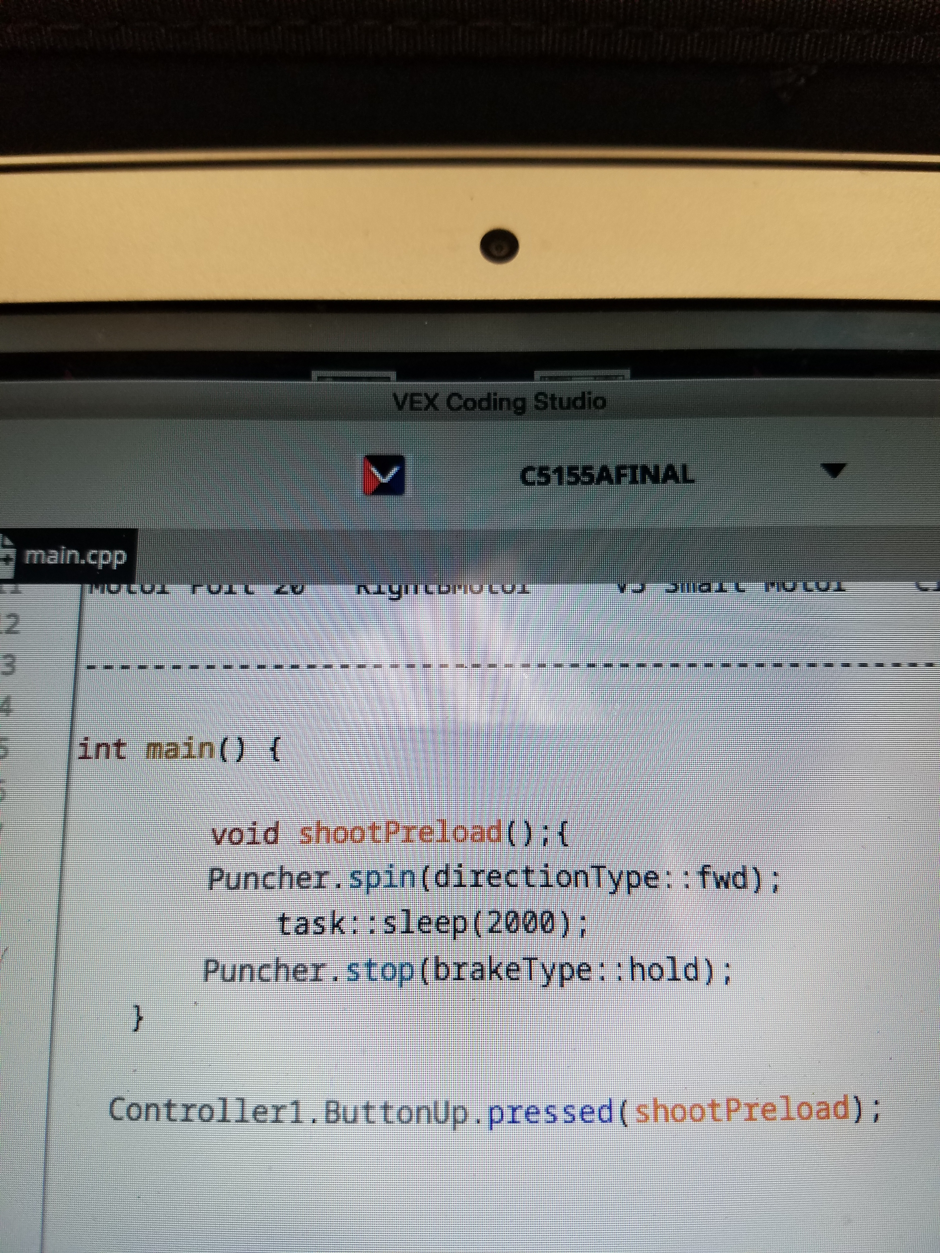

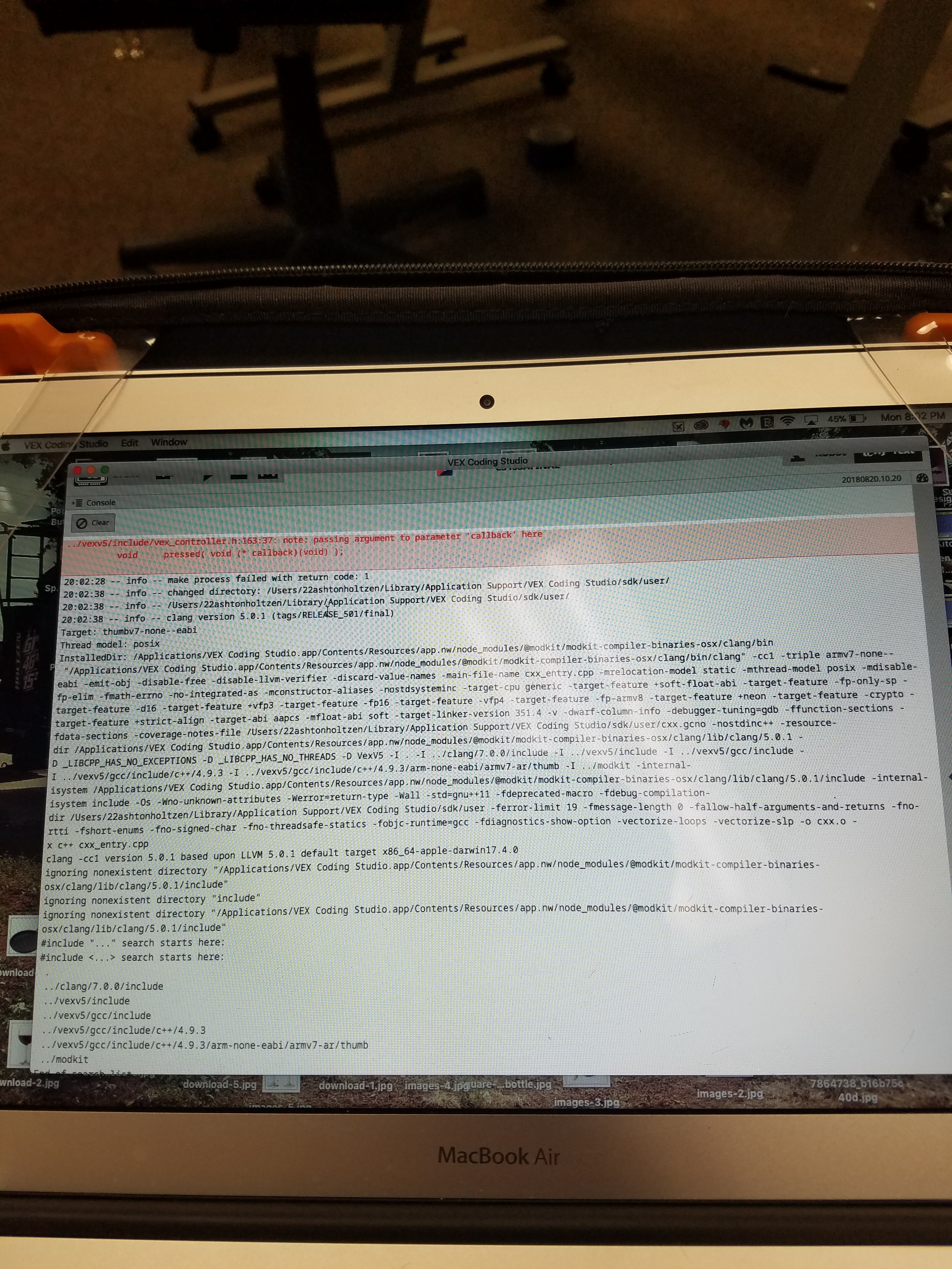

When I put that code in like showed it gives me this complication error. What should I change.20190408_200316 20190408_200258
This would be the structure for the program:
// this is created by VCS graphical configuration
#include<robot-config.g>
void shootPreload() {
  // write your code to shoot the preload
int main()
// register the up button to shootPreload
  Controller1.ButtonUp.pressed( shootPreload() );

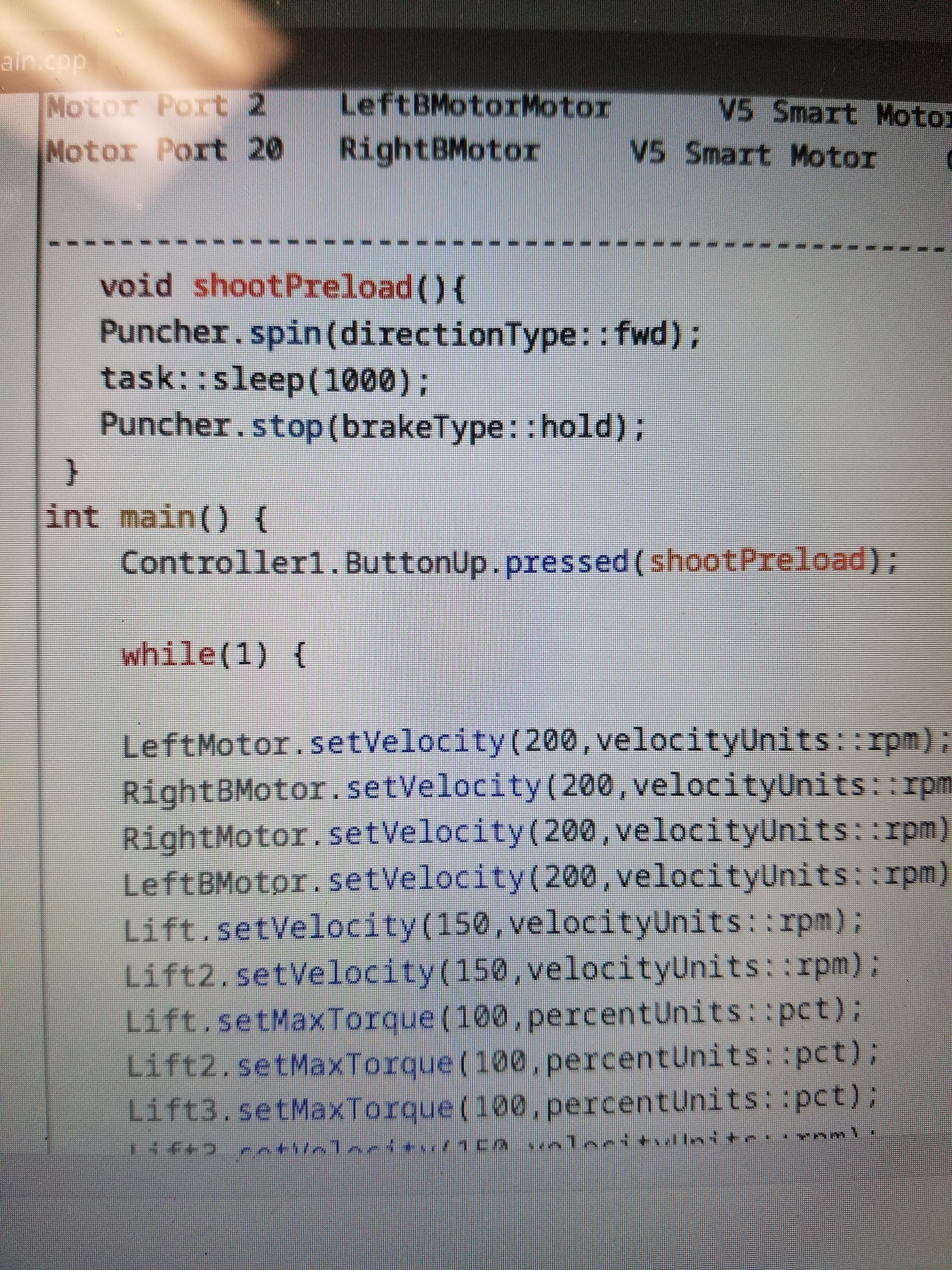

I am but I just put your code in and it wont run the puncher motor at all.20190409_075410|375x500
If you post your code we can probably help more. Preferably in a form where we can edit it. Cut and past in the text will be ok.
20190409_075410
Well here’s the code it is just a picture I can send you the full program later.
Do you see anything wrong with it
Your button pressed is not in the while loop, so it will not be called continuously. Not sure if that is what you’re trying to do or not though.
I don’t see any syntax errors or anything from a glance.
It should not be - it is registering the function to be called when the event happens “pressed”. You might be thinking of .pressing which is different.
Ah that makes sense now.
Do you think it should work or what do you think is wrong with it.
It’s entirely impossible to tell what might be wrong with it, as we can’t see everything that’s going on. That’s why lacsap asked you to copy and paste your code here so people could look at it. Sign into the VEX forum on the computer you’re coding on, copy and paste the code into a reply, highlight it all, and click the </> button to give it code formatting.
What’s blocking our view is all of the setVelocity and setMaxTorque commands at the top of main’s while loop that don’t actually need to be there. But even then, only ten lines of main is probably not enough to see all the substantive things you’re doing in there. Camera photos of monitors are almost never useful for diagnosing problems on a working computer.
