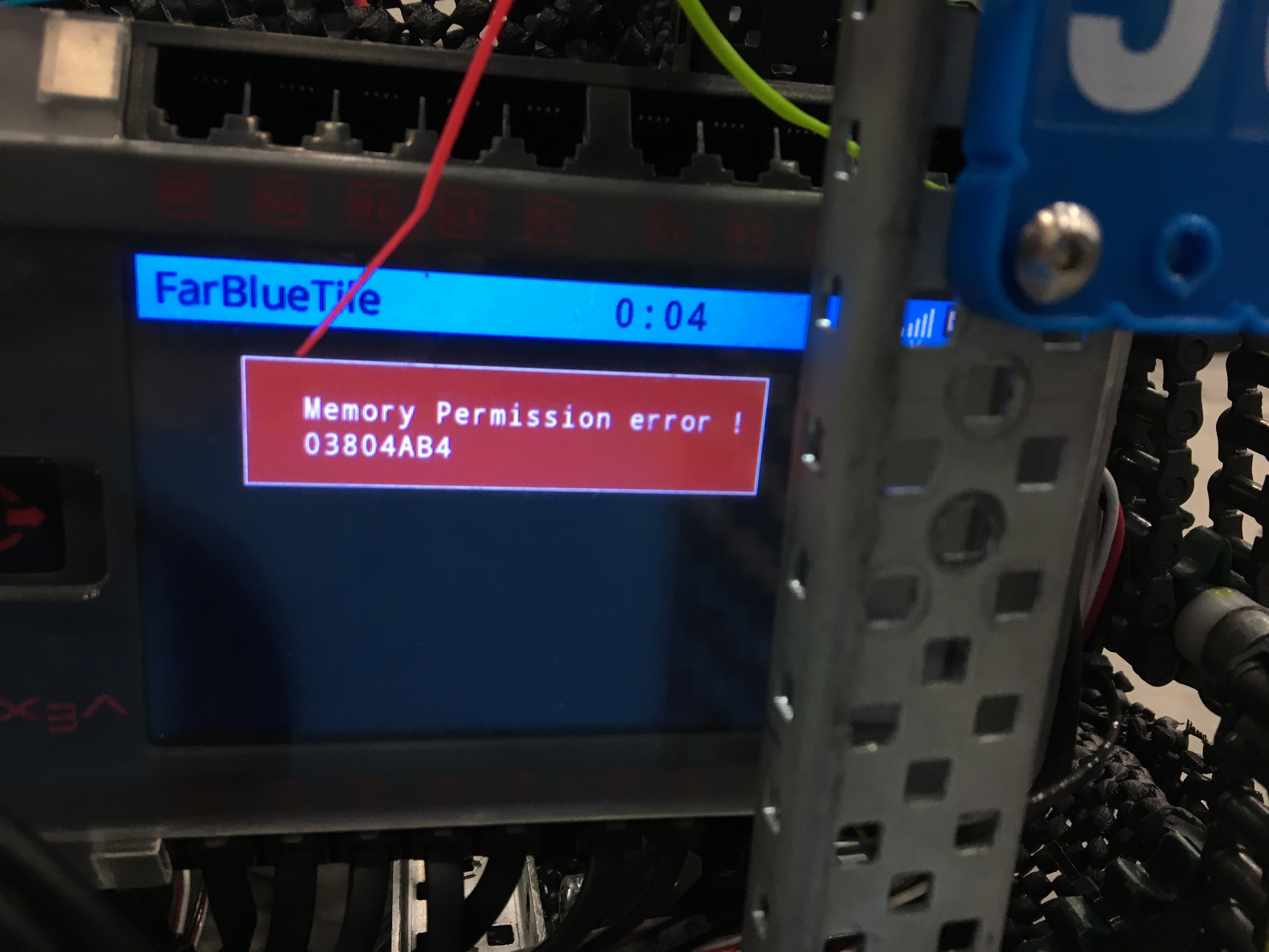

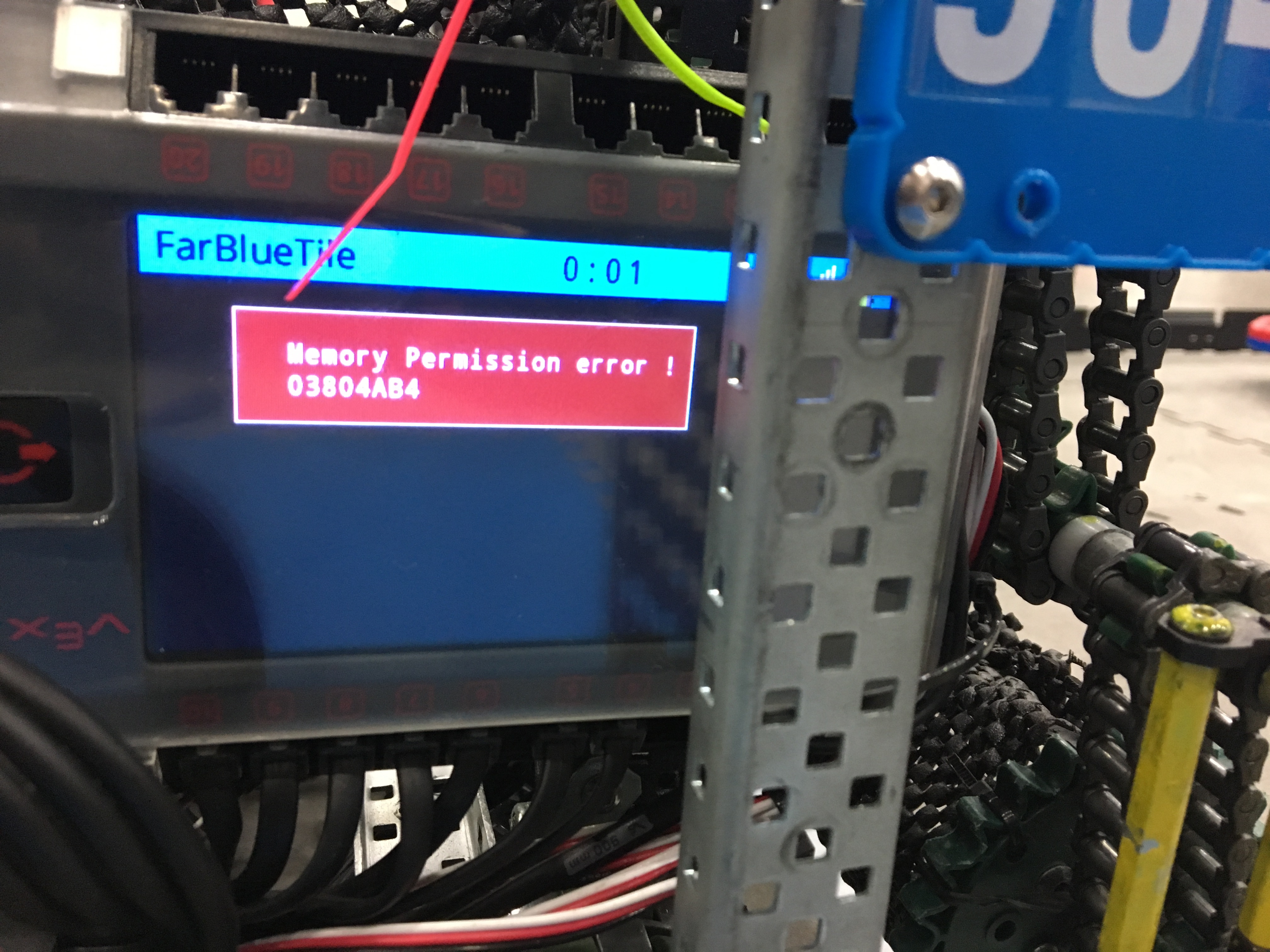

During worlds while in our pit, our team encountered a strange error with our v5 brain. This said error occurred whenever we would activate our autonomous with the controller. Nothing would run for autonomous and simply gave a memory permission error on the brain. We had managed to fix this error by redownloading our code. We use vexcode with wireless download.
