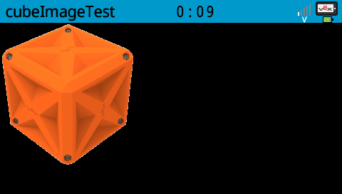

So lately I’ve been trying to display an image on a v5 brain using an SD card to no avail. I’ve looked at many different forum posts and tried everything from converting files to optional declaration methods yet nothing seems to work. The screen just remains blank. Can anyone help me?

I am using VEXcode and this the code I’m using for testing:

int main() {
    Brain.Screen.drawImageFromFile( "cube2.png", 0, 0 );

works ok here.
cubetest
is vexos all up to date ? (1.0.9)
is the SD card formatted correctly ? (fat32)
It’s all up to date, but I don’t know how to format the SD
you would format on your Mac or PC as any other SD card, just make sure it’s fat32 format not something else.
So the only options it’s giving me for formatting are NTFS and exFAT (which is what it is now)
well, neither of those will work, are you on windows 10 ?
