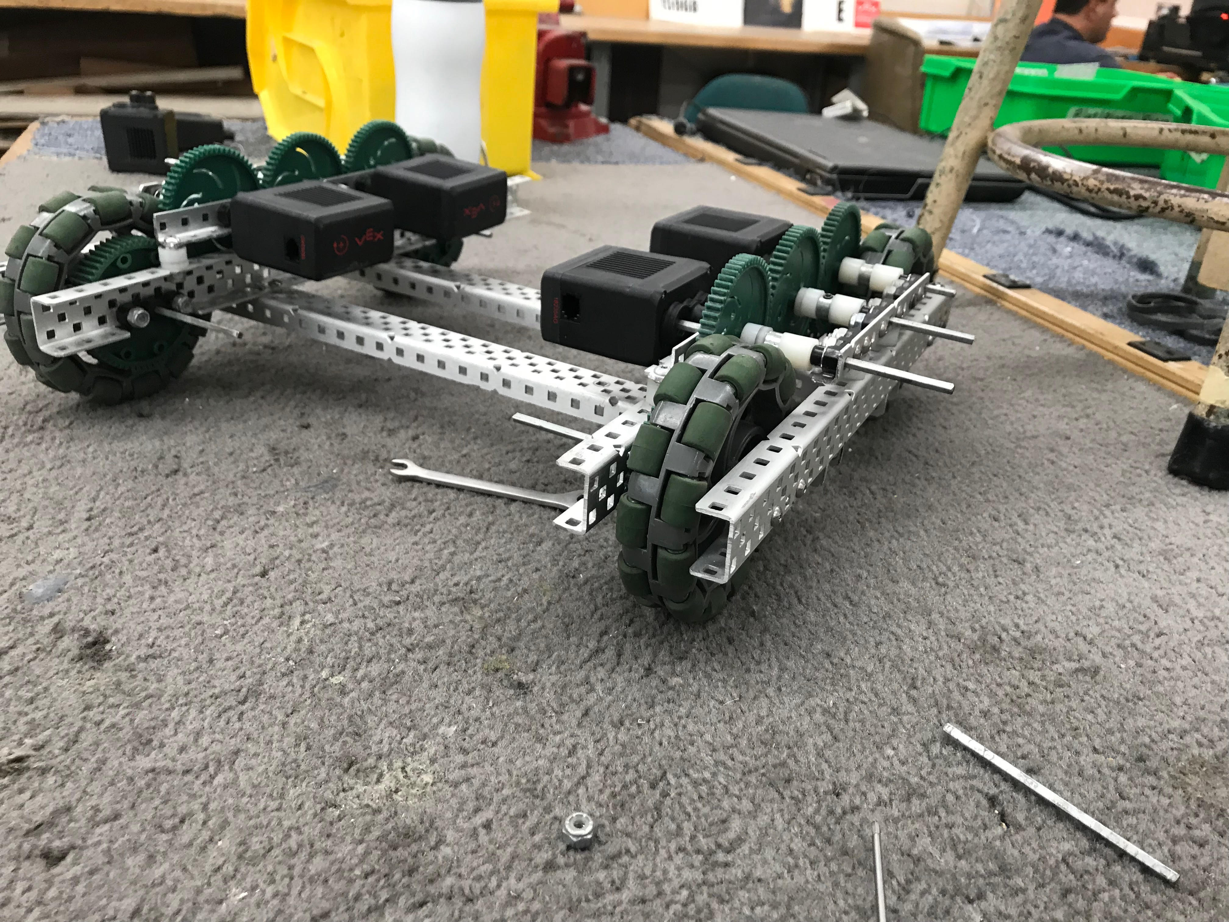

The left side of the chassis is geared in a way that both the motors spin in the same direction which is why “true” or “false”/ “rev” or “fwd” is the same for the respective side of the robot that those motors are on. I hope that made sense.

*Note this is an old image but the configuration is exactly the same. This is an image of the back of the chassis. So the intended forward direction is furthest away from the camera.

Do you really mean the motors or the wheels ?
Are you referencing the motor direction to the arrow on the motor casing ?
Yes. The problem is that I changed the motor directions and nothing happened. And this still doesn’t explain why the buttons register only sometimes.
Also, technically speaking, the direction of the motor should turn the wheel the same way just because of the way it’s setup.
