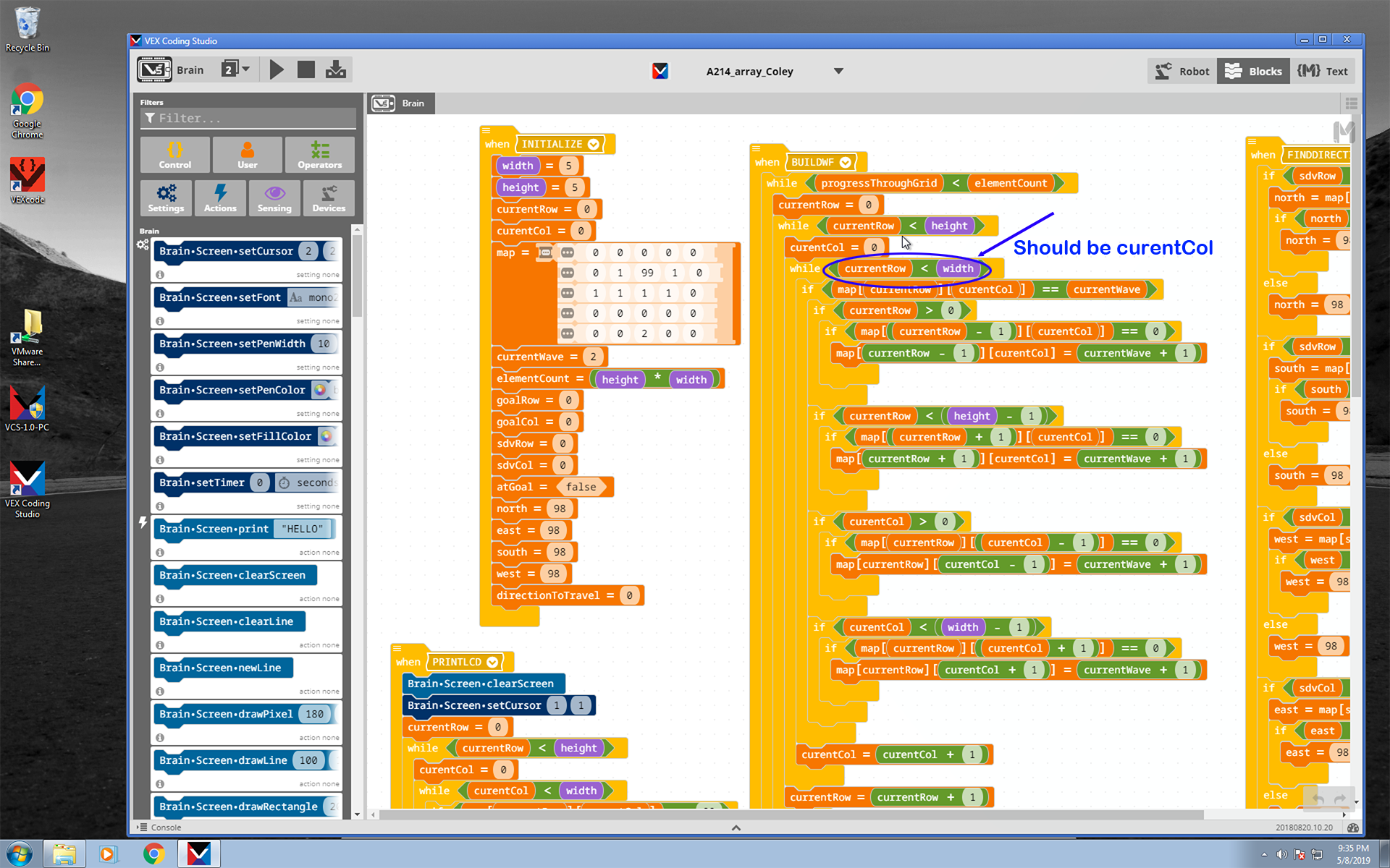

I am getting a Memory Permission Error ! 03802A38
I am using ModKit, for the CSE Curriculum. I’ve looked at the code, and I am not able to isolate the problem. Any ideas?

That must have been a very specific case, we probably tried the code on another brain and it ran ok. A memory permission error is most likely due to using an initialized variable as a pointer or something like that, not uncommon, usually a simple code error.

There’s an error in your code, see below. You end up accessing elements past the end of the array, that causes an error.
A214_array
