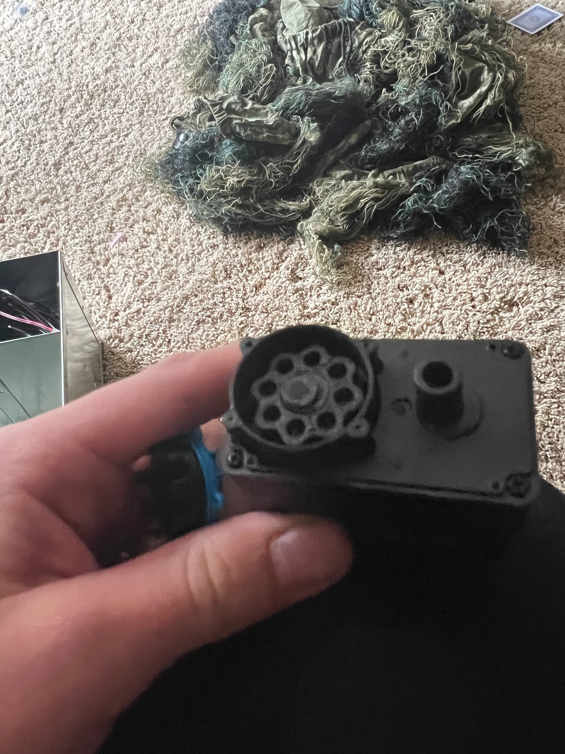

Speaking of custom cartridges, here is a differential cycloidal 45 RPM cartridge I designed:
It can handle the full torque of the motor- you can stall it. DM for more info if you want the files or anything :))
That’s neat! Glad to see other teams experimenting with custom cartridges! I haven’t looked into anything other than planetary gearsets yet as there is a lot that can be done with them. I still need to get into triple stages for sub 100rpm, and reverse stages to get ratios past 3600.
