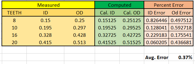

My key findings when reverse engineering these parts is that the gear is nonstandard as follows:
The pitch diameter (Pd) of the gear in inches can be found with the following formula:
Pd = 11 * Teeth / 500 + 0.0295
[the pitch is 45.4545 (fraction 500/11) with a static offset of .0295].
Addendum is 0.022875" ( fraction: 183/8000)
Dedendum is 0.027125" (fraction: 217/8000)
To get these numbers I measured the outer and inner diameter of each gear and plotted a best fit line in excel.
Graphs1
Because pitch is a linear relationship, the slope of these lines gives the approximate pitch. I then measured the shaft spacing in the 100rpm and 200rpm cartridges, and using the mathematical relationship of planatary gears along with the estimated pitch I was able to establish the addendum and dedendum (distance from outer and inner diameter to the pitch diameter). From this I then could directly calculate the pitch diameter of each size gear and plot them to establish the final formula.
graph2
I then double checked the results by using this formula to find the theoretical outer diameter and inner diameter of each gear and calculated the percent error of the measured gears. I found a maximum error of less then half a percent (0.5%), which is well within the manufacturing tolerance of the gears.
Error
