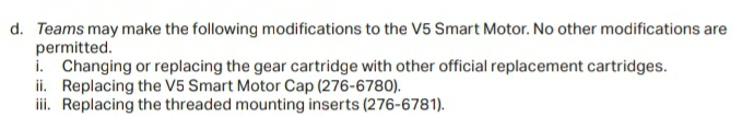

According to the VEX Robotics Competition Game Manual, Rule R22:
Screenshot_20210426-212530_Drive
It is unclear whether or not a competitor would be breaking the rules by replacing their internal gearing, hence implying that they’re “not supposed to be handled”
However, if you are not competing while using that repaired motor, then it does not matter.

On the contrary, I made a forum post asking if I could salvage a broken motor I had, and alas people told me I could not. However, the people of the forum also informed me that it would have already been illegal to use that motor again, because I had disassembled it past its “user-serviceable” stage. I looked on the VRC Q&A section, and it says that further disassembly (even if you aren’t modifying it!) is not legal. Take a look:
"The Q&A’s linked above clarified that V5 Smart Motor Cap, as a part that is intended to be user-serviceable, is also included in this group. Although this is the first question that has mentioned it, the threaded mounting inserts were also intended to be user-serviceable. These points will be added to R22 in a future game manual update.
Any further disassembly, modification, replacement, removal, or re-purposing of the V5 Smart Motor is neither an intended design of the motor, nor an intended design challenge in the VEX Robotics Competition, and would not be legal."
My main point is not to be counterproductive towards the conversation, I am simply warning the OP about the fact that disassembling the motor past its user-serviceable stage is, in fact, illegal in VRC, just as I was informed when my motor stopped working. Will inspectors notice that you put a replacement gear in your motor? Probably not. However, I know for a fact that some people cannot live with the reality that they have broken a rule (my sister team).
Once again though, if the OP does not plan to compete with this motor being used, then this ruling does not matter.
