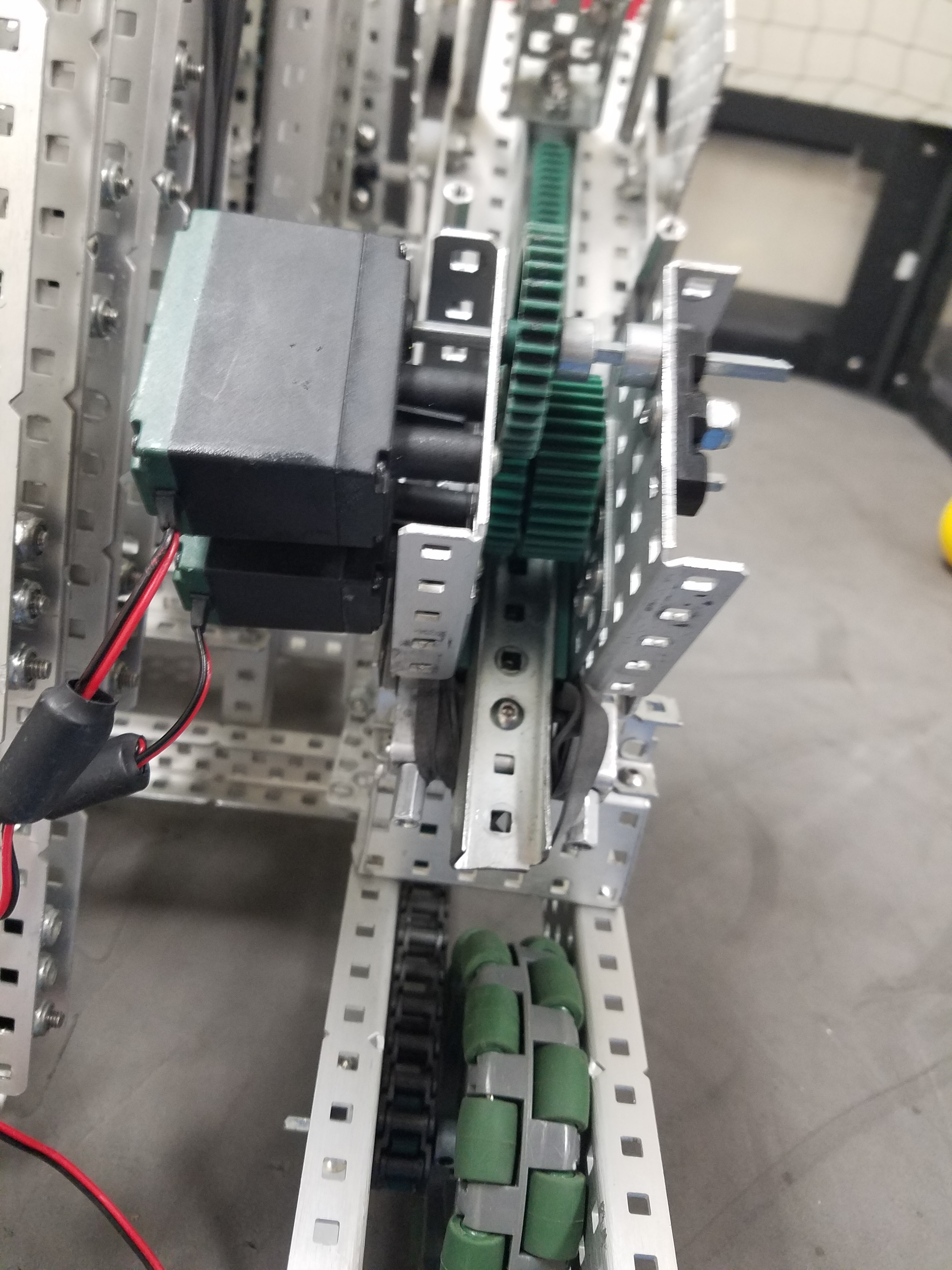

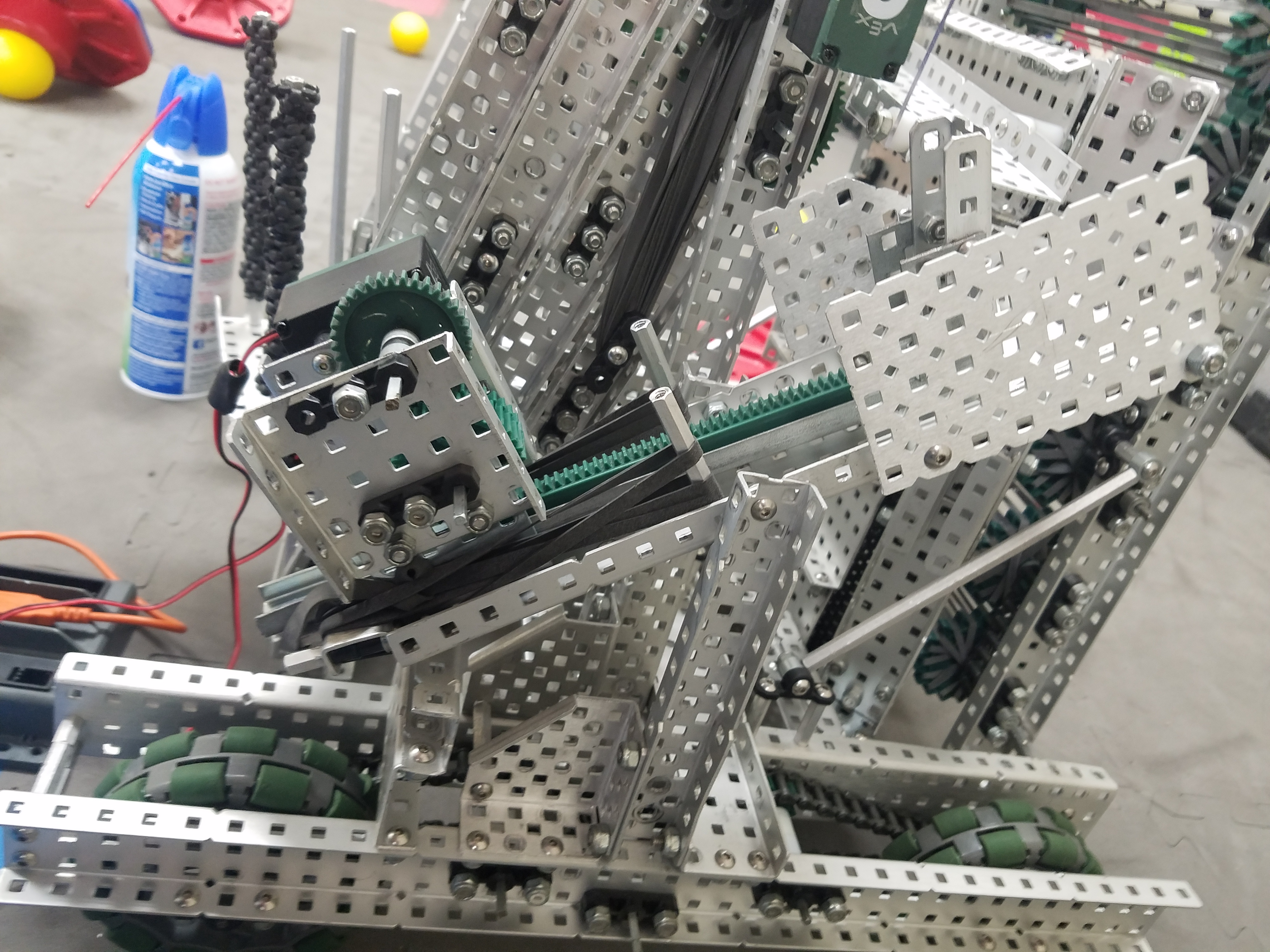

So, we just got v5 today, and we put it on our puncher with 2 rubber bands on each side and it could not pull it back. Also, just running with 1 rubberband on each side for like 10 punches the motors started to get hot. If anyone has any solutions it would be very helpful.

This is it it just has 1 v5 motor and not 2 v4.

Are you absolutely sure you don’t have friction popping up in your system somewhere?
I noticed you have one black bearing that appears to have only one screw holding it in place. If so, this could be one source of friction as sometimes a bearing mounted like that can rotate a little out of alignment and put large amounts of friction on the shaft. Also, I notice what appears to be a metal shaft collar very close to the metal housing - I’m guessing you have a thin plastic washer there to avoid metal-on-metal friction?
Last, I would suggest checking to be sure your rubber bands aren’t somehow getting jammed in the mechanism here and there. They look like they are not neatly contained and maybe could get caught in various pinch points during operation. Some kids will put zip ties around their rubber band bundles to help keep them from getting caught in things. Just a thought.
