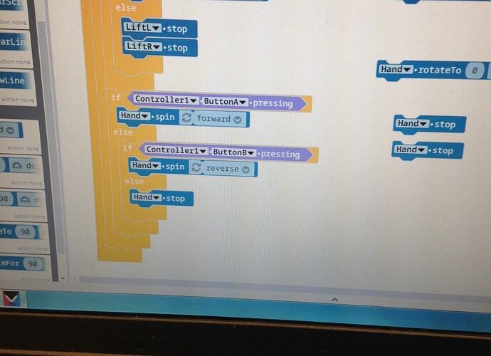

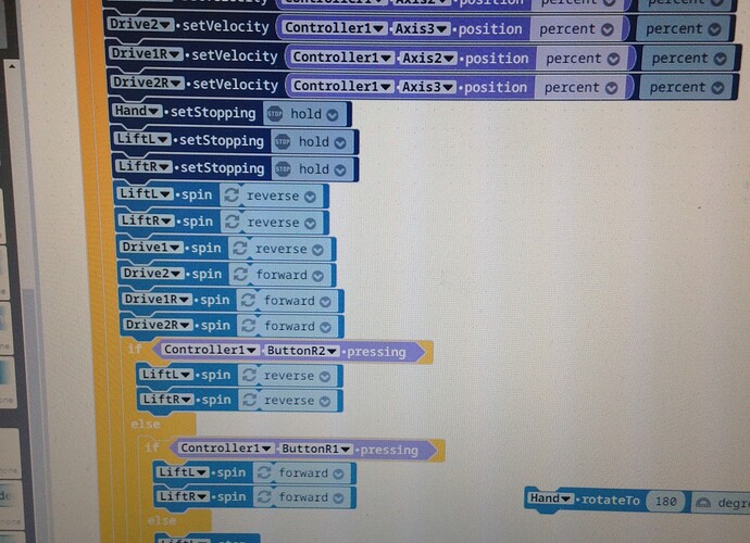

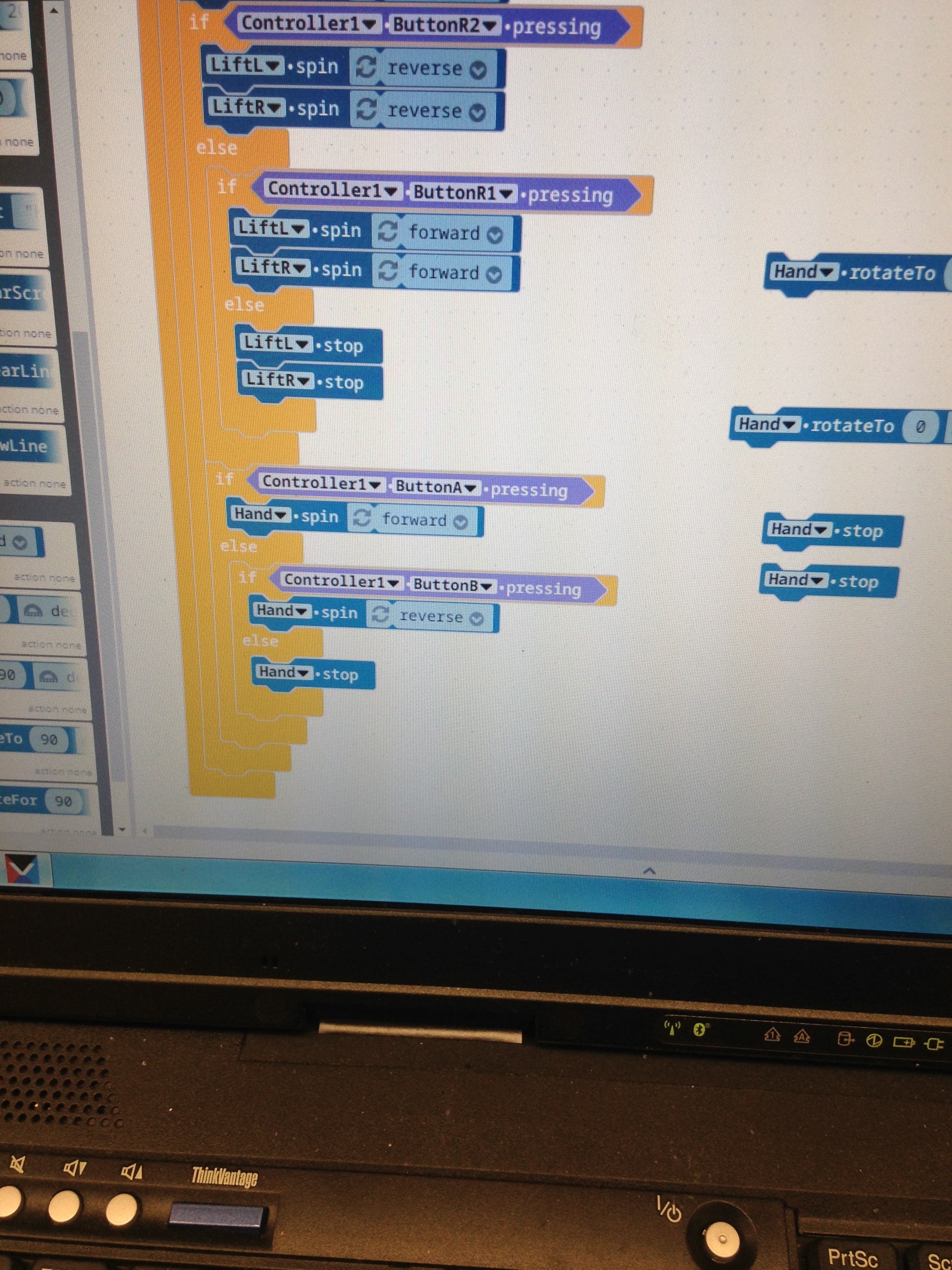

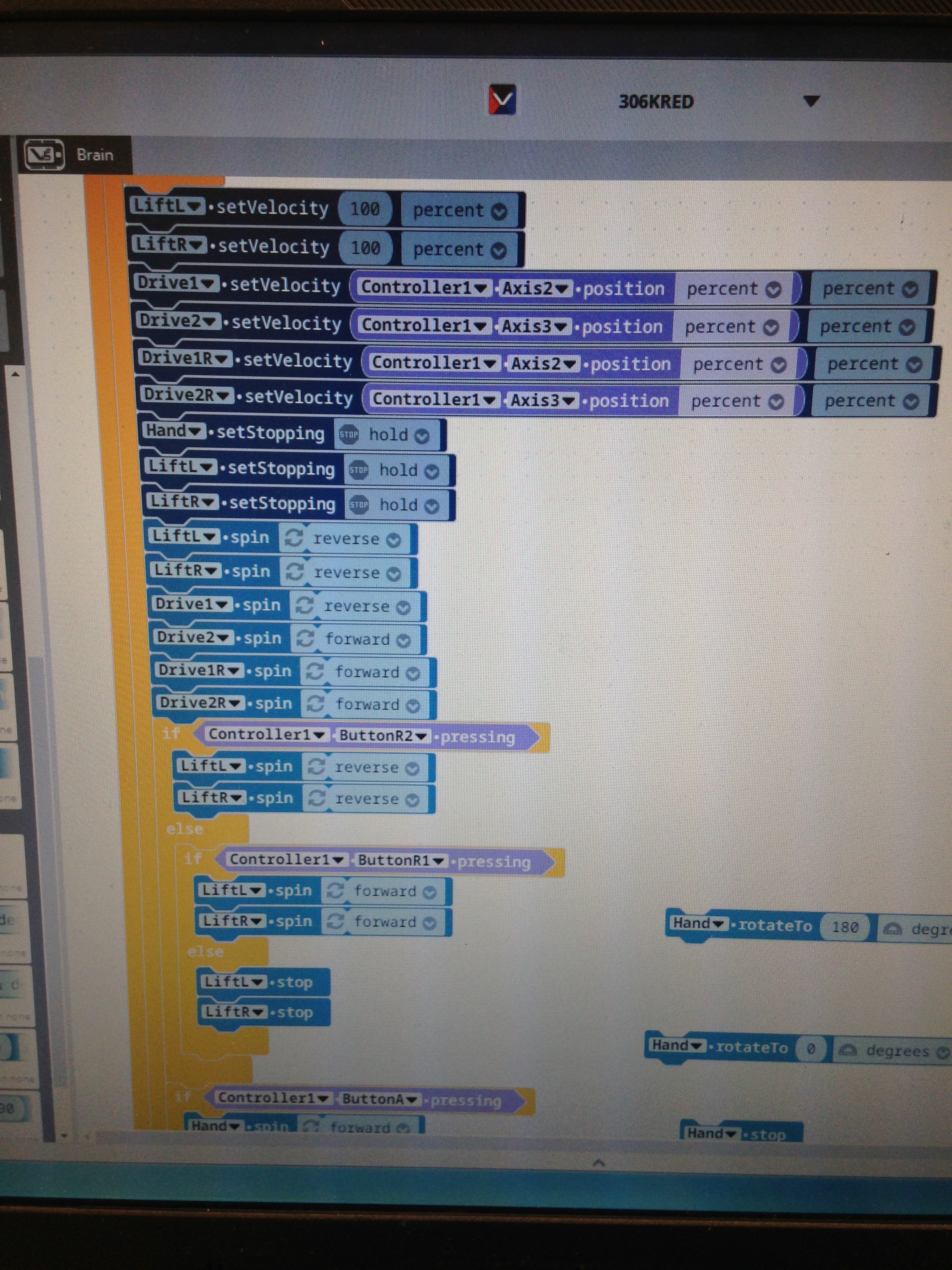

Hello our robot has a motor that flashes red, this occurs in any of the motor ports. It worked less then 10 minutes ago but then it stopped working completely. It controlled our hand which rotates the waffles. It was set to rotate 180 degrees when the button was pressed, then we tried to switch it to just rotate but it wouldn’t even do that. The light pulses very slowly for a long time then after some messing around we got it to pulse fast like really fast
