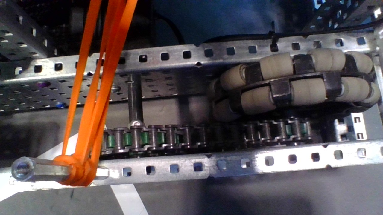

IMG_20210108_151929
So… From this way, It looks like the 5 wides on the base are steel. That’s gonna be pretty heavy, might be part of the problem.
i dont think that would be significant enough to cause nylon gears to melt…
as long as the entire bot isn’t made of those steel 5 wides, i think it’s safe to assume that it’s something wrong with his drivetrain rather than the weight.
What are these two structures (specifically, whatre the rubber bands for and what is the piece of metal that looks like it’s touching the sprocket are the bottom)? have you tried disconnecting the motors and seeing how it freespins? The picture helps but by itself it didn’t provide a whole lot about the context of the problem (assuming this problem is mechanical in nature)

Its pretty much an all aluminum frame and those rubber bands make our front intakes stay inward so the ball does not slip out.
we have tried free spin
can you send a video?
Yeah it depends how long it’s free spinning for, which is what ethan is inquiring about
Have the motors taken any impacts? Drops off tables? Driving off fields? Run off a curb?
How many rpm are your motors spinning at. Also, how many motors do you have on your drive train. If you had a 2 motor drive train and have the motors at over 200rpm, they would burn out pretty quick.
Don’t hear down a motor with sprockets when you’re that close. You should use HS gears to put less strain on the motors
You have black spacers on your drive wheels, are you able to spin those by hand pretty easily?
