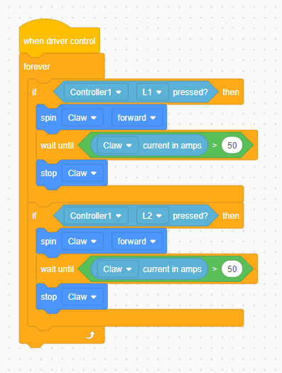

So for like a claw, i would just monitor if there is a spick in voltage from the motor wanting to move but not being able too?
Like this? With the ā€œ50ā€ being adjested by what ever numbers it needs to be.
Yes that is essentially how it should work. Now you need to get accurate current levels so you can get it to work. Also I would suggest making the current level set that it will detect at a slightly lower current because I doubt that it will be consistent. Just high enough that it doesnt detect without that. The biggest concern is consistency so if you get that then you should be good. (Oh and im not our coder so I cant say the code is exactly right but it looks right to me
cool, all good tho, I’m not the coder either. My coder is just super lazy :laughing:
That code will work for the question asked… but it will make the motor/claw unstoppable… when the button is pressed the claw will move to either full open or full closed… and you can’t stop it in the middle.
For reference… 2.5 amps is maximum before motor’s internal protection kicks in.

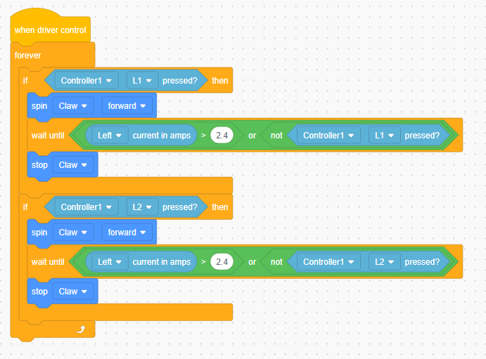

So would this let it stop in the middle or when it maxes out?
Yeah… assuming that ā€˜claw’ and ā€˜left’ are the same thing.
ope, good catch. Thanks
