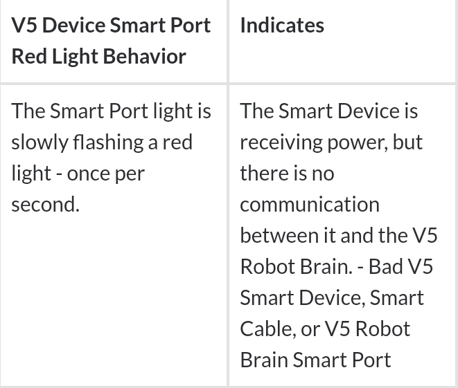

I have at least 6 motors that won’t move. I can manually spin them like a regular motor. And when I plug them into the brain the red light on the motor flashes quickly every 2-ish seconds. They seem like normal motors, but when I plug them in, they don’t work. Other motors work on the same port with the same wire. Are the motors shot? If so, what can I do (if anything)? If not, how can I fix them? Thanks!

Have you tried with other wires? It’s pretty likely that the motor is the troublemaker here but it’s hard to confirm it entirely until you test multiple ports and wires. From personal experience, I can say it is possible that faulty wires will work with one electronic but not another. Usually, if a motor is dead, it’s unlikely you will get a flashing red light, you normally get no illumination at all, which is why I still have hope that the motor is alive.

in my experience an unresponsive flashing motor port on an otherwise working cable and brain port means the motor (possibly motor port?) is fried. Has been a lot less common than brain ports frying in my experience, but still happens relatively frequently in static-prone environments.

then i would suspect that your motors are just dead because as the first reply said the blinking light means somethings wrong
That means there is no communication with the V5 brain and the motor is running in the bootloader code.
most likely.
There can be two causes for this.
The pins of the smartport on the motor may be damaged, check to see if any are bent and not making contact with the cable.
The internal RS485 driver may be damaged, there is no competition legal way to repair this part.
