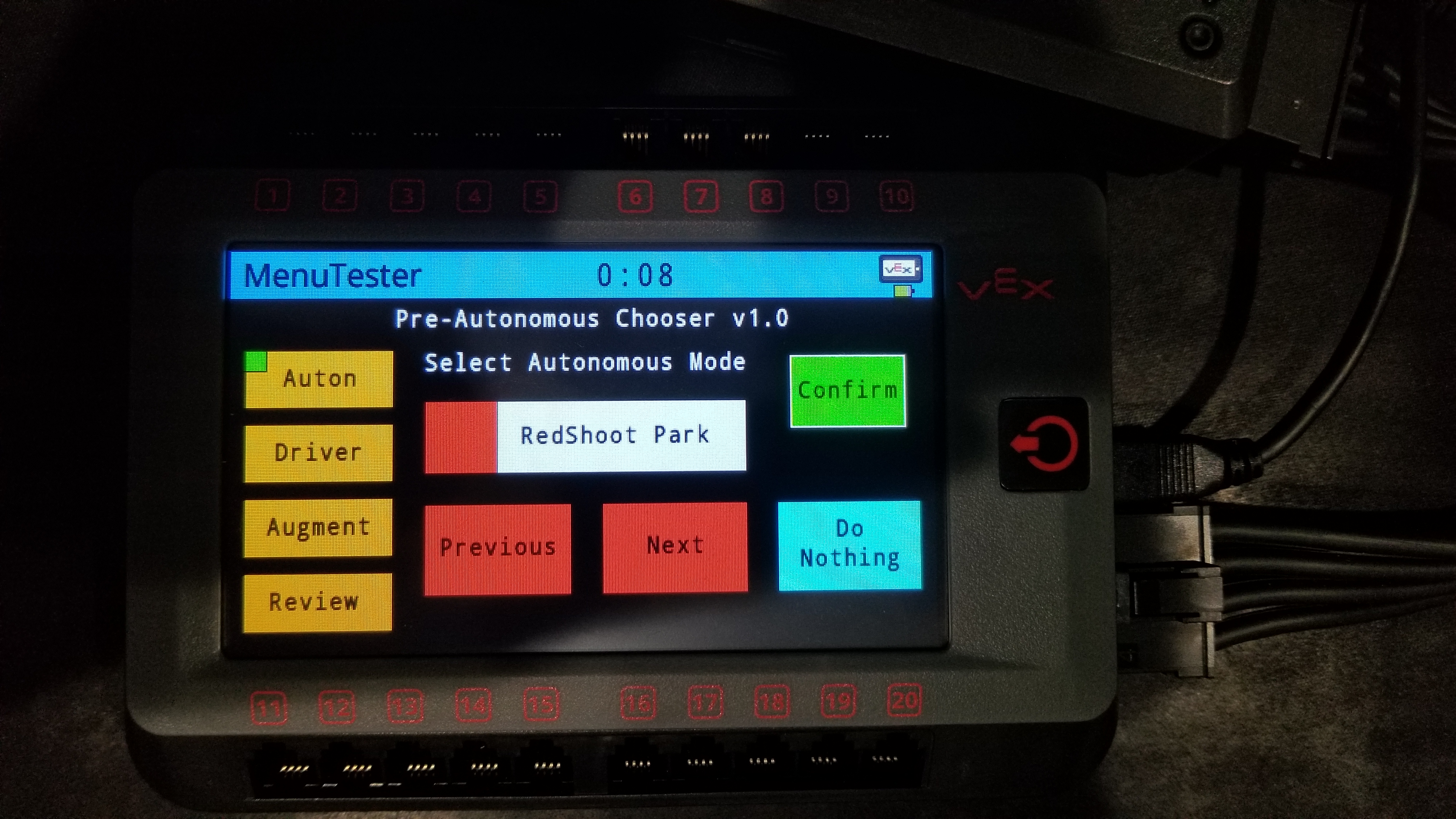

Here are some images as well:
Autonomous Selector
Autonomous Selector

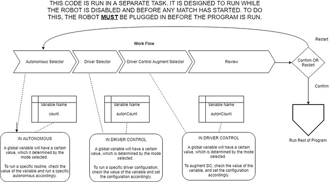

Menu WorkflowWorkflow
