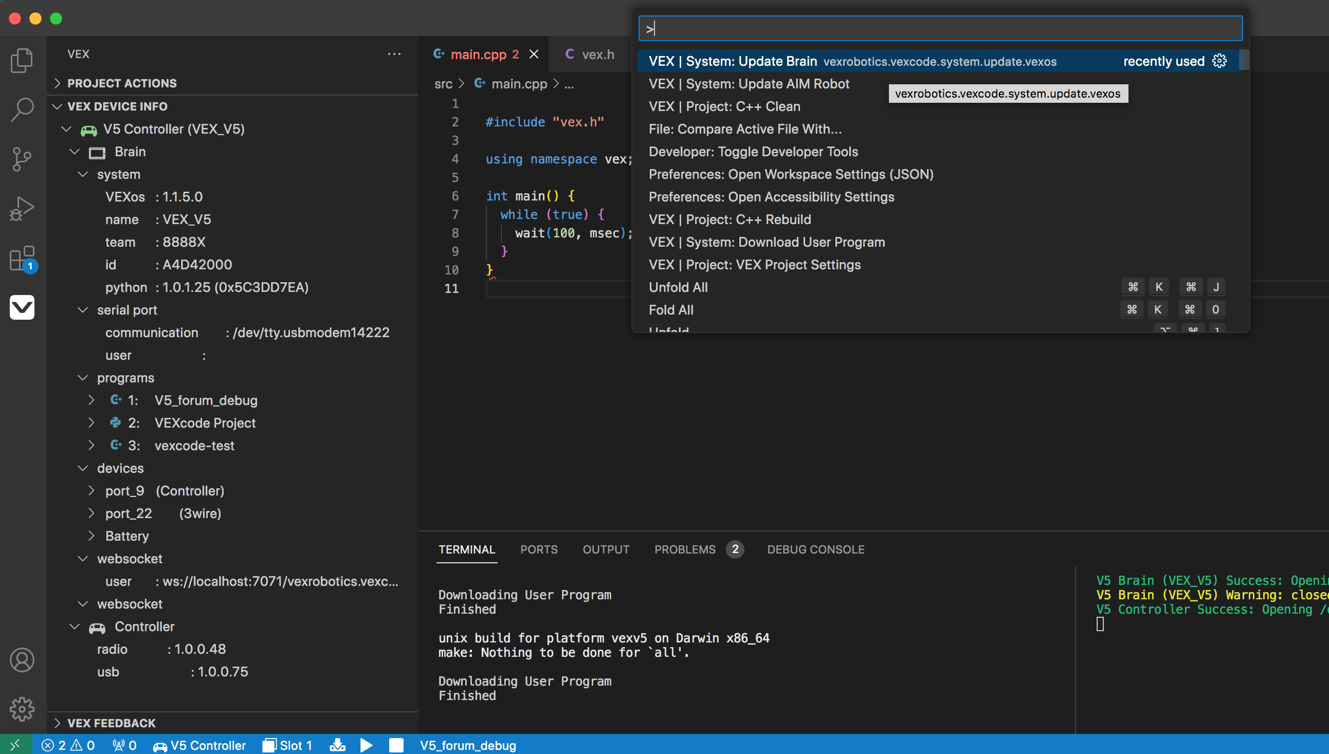

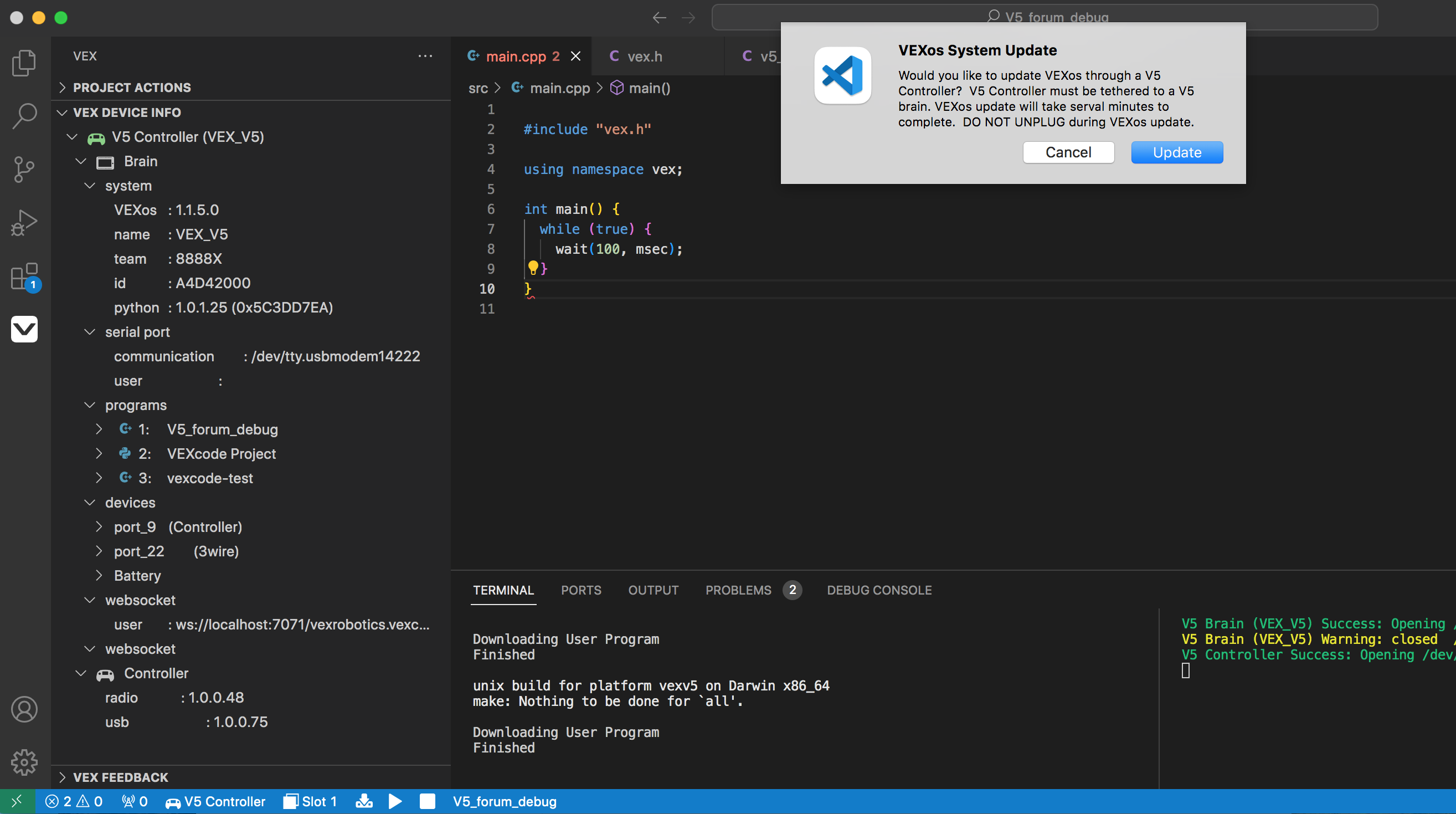

We allow brain firmware update via a tethered controller (ie. Connect the controller to the V5 brain using a smart cable) from the VSCode extension. You have to start this manually and it will take several minutes.

When we first looked at this, I tested with updating from 1.0.7 to the latest vexos. However, there were improvements made in vexos 1.1.0 that improved reliability. This should only be used as a last resort method of updating, it will take 7-8 minutes and is not guaranteed to work 100% of the time. One issue is that during certain parts of the update the V5 brain cannot continue to communicate with the controller, obviously this creates an issue when relying on controller to brain communication as the update path, we have to work around that issue and it has been improved with more recent vexos releases.

Like many in this thread, we have a brain with a broken USB port. We tried using the VSCode approach, connecting the controller to the V5 brain via smart cable, but unfortunately the VSCode Vex extension doesn’t show the option for upgrading the firmware. Our current brain is on 1.1.2, so we’re trying to upgrade it to 1.1.4. We are running VSCode on MacOS. Is this firmware upgrade path something that’s only supported on specific versions of VSCode (ie.: Windows)? Or is there anything else we need to change with our VSCode setup?
You have to initiate the update manually.
select update from command palette.
follow instructions.
Thanks a ton for that last tip and for everyone’s input on this thread, it worked perfectly! We now once again have a working brain that we can use in competition, team’s super excited!
