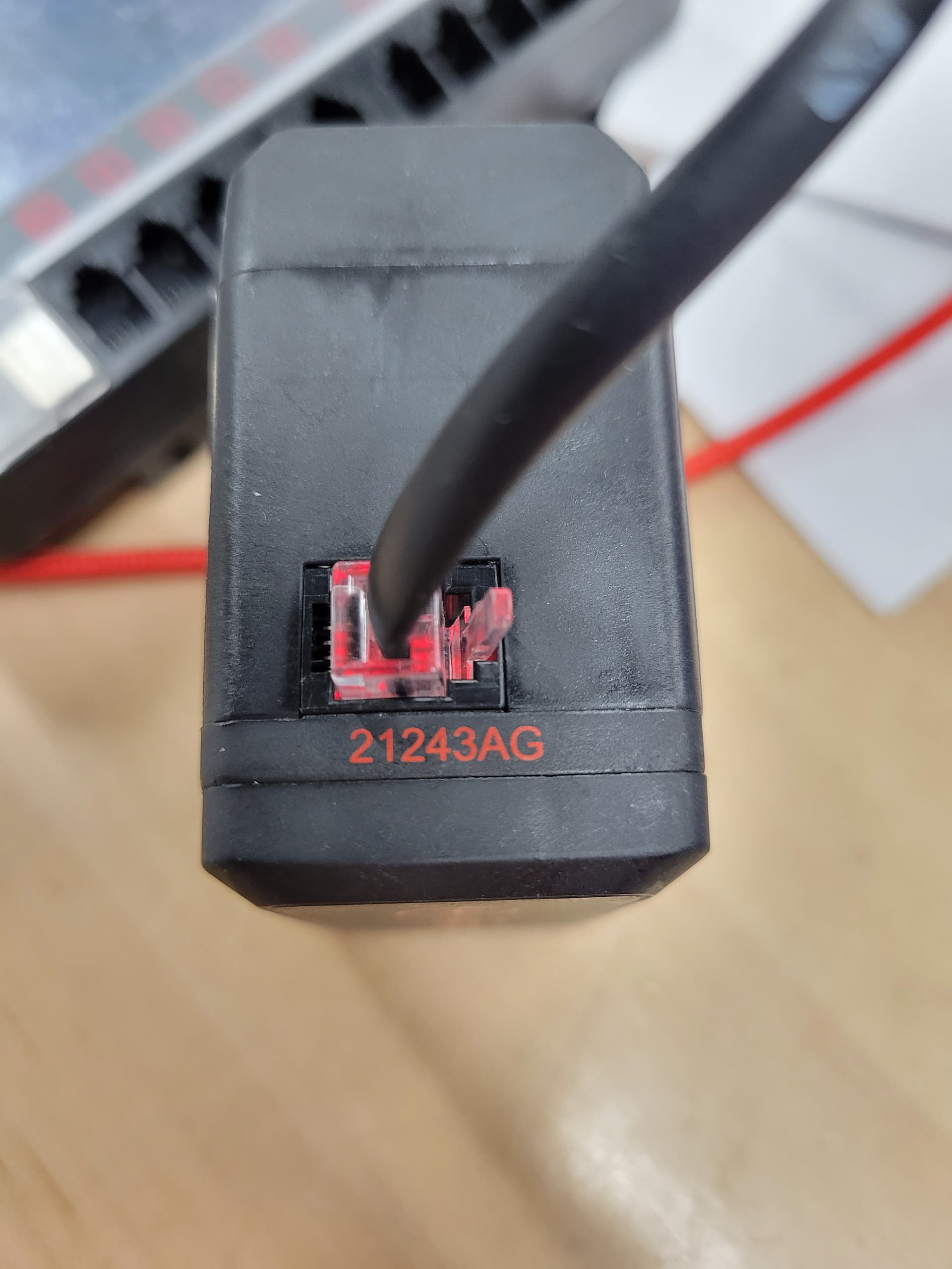

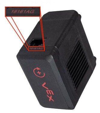

  • Locate the date code on your motor (see image below).
  • If the first four digits of the date code is “2143” or higher it is possible that this motor is a rev 10 and can be returned.

@jpearman so would I be correct in assuming that I wouldn’t need to worry about this motor because the number is low enough? Or do I need to test these 2022 motors even if the first 4 digits are below 2143?
That motor shows a solid red, it’s working, use the test program.
We did all the motors that were even close, only ones that ‘failed’ were past / greater than the date code.
If you received it in 2022 then I would test it.
The test program is plug N play, that is, you can leave it running and just plug and unplug motors and it will update the version status for that port on the brain, no disconnect screens will be shown, so it’s pretty quick to run through a box of motors and check them.
