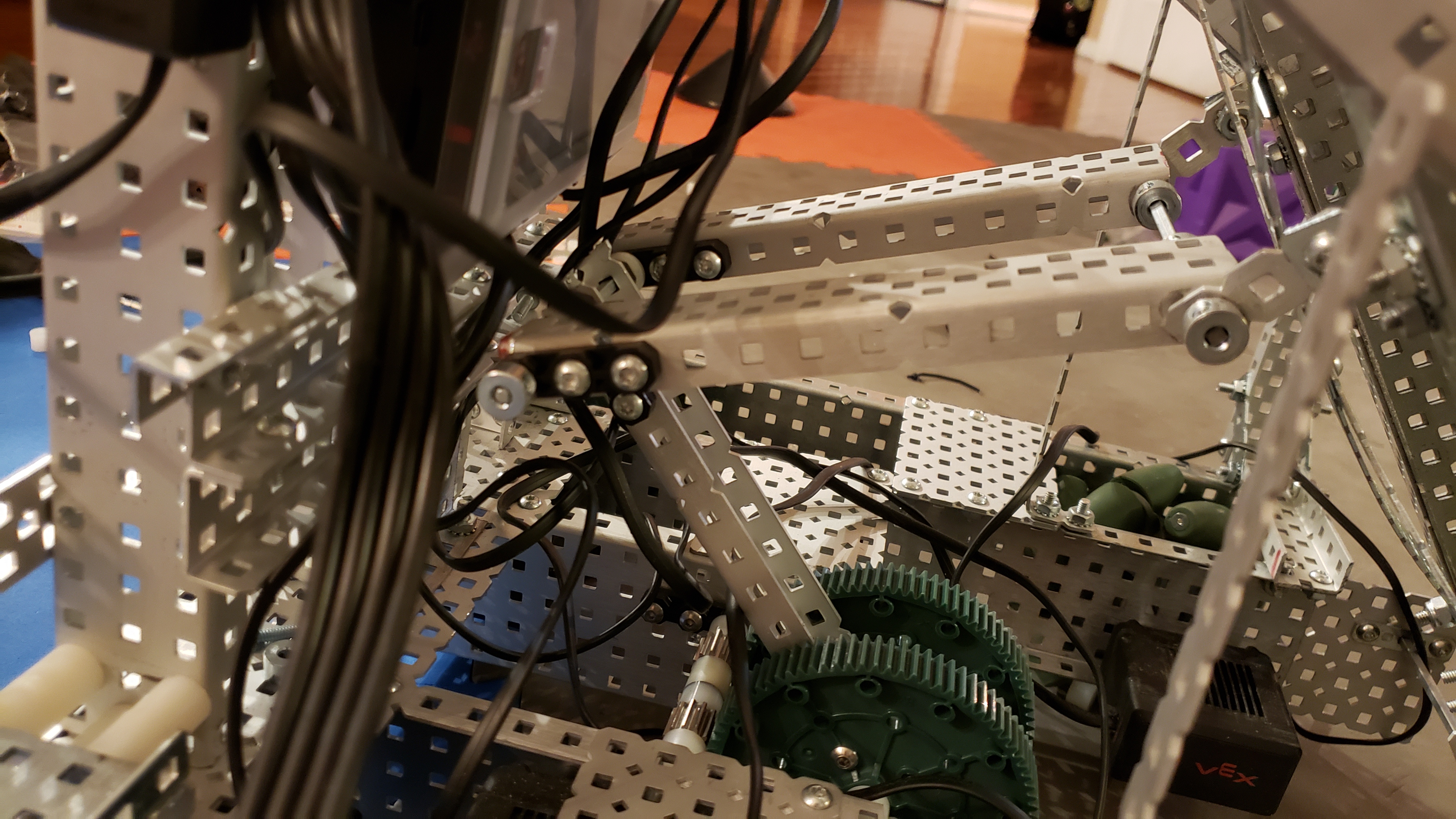

Ok, so I’m having trouble where to put my cortex? Last year, it was in a horrible spot, and I want to make that better this year. Also, if you have any tips/tricks with v5 I would be happy to know!
Make sure to put your cortex or brain in a safe but accessible spot. Maybe on a base of an arm. If you are doing tray bot. I might suggest putting a bar underneath it so you can have your battery and cortex since the tray will protect it and it will be out of the way.
The thing is: my tray comes back with this mechanism and would run into cortex

I cant help but notice you are using axles on your tilter joints, I’d suggest replacing them with screws.
One more thing, your topmost tilter joint (what is connected directly to the tray) only has one axle transferring power directly into the C-channel. I would suggest putting some bearing blocks there to prevent the axle from damaging the metal over time, or just switching to a screw joint.
Oh. Maybe add a slim bar that goes across the arm’s base that can fit the cortex.
my coach has mentioned that using axles as tilter joints would be better, but I don’t really understand in detail why. Don’t screws align better with the bearings making them more precise and smooth?
IMO you’re right. There’s very few times where you would pick an axle over a screw joint, but you should ask his reasoning.
Honestly the only times axles should ever be used as joints is when you are powering something directly from the motor. Most any other time a screw should be used (unless in the case of screws not being long enough)
Screws are able to be cantilevered, support heavier loads, and in many cases they have less friction than axles. Axles can be directly driven from a motor and can span longer distances (not that they would be particularly useful over much more than a 3” distance)
If you’re powering a lift with only one motor, you’re gonna need a long axle somewhere depending on how compact the lift is. It’s basically impossible to link power across long distances without compromising on friction or space in which case using an axle makes sense.
Axles aren’t bad, they’re just not properly used. You should drill out the hole the axle goes through and make sure the bearing blocks supporting the axle are perfectly aligned. Depending on load, you might prefer a high strength axle over low strength. In the case of a joint, axles work fine as well so long as they are properly aligned and if using gears, a green insert is used. Though the shape of Vex axles aren’t particularly better than that of a screw, the stress load an axle can hold is not significantly less than a screw. You only see a large difference because a screw doesn’t span over 2 inches. Nonetheless, I’ve bent many screws before.

In general, I use screw joints because they fill in the little gaps in a bearing flat to a greater degree than an axle. If the axle is not rotating however, a screw or axle can be used interchangebly. I like how easy it is to cut an axle but shaft collars aren’t the best locking hardware. So if I were to choose, a screw and nut is overall better performing.
