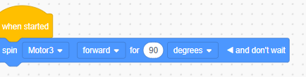

This is a very elementary coding problem that my students and I have been unable to solve with the block coding. When their robot design includes multiple motors that control wheels, we cannot figure out how to use a single start block if several of the motors need to function at the same time. What happens is the motors run sequentially. Other than using different start blocks for different motors, we haven’t been able to solve this problem. The students have built H drive robots and we are trying to work out the block code to get them to drive forward and then sideways.
The essential problem that you are facing is that by default, VEXcode movement blocks are set to wait for the motor to stop moving to continue to the next step. To fix this, you would:
