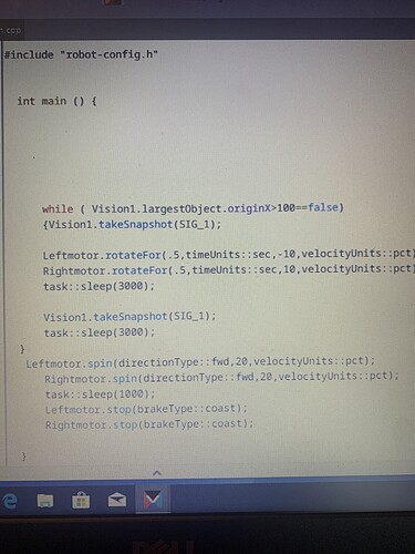

I’m very new to programming and try to help my son School team with their new V5 robot. I’m trying to program the robot to sense a color and turn to a centerX by using a while statement. We are using the VEXcoding studio and c++. Any help will be greatly appreciated. Thanksimage
What is the code doing right now, and how is that different from what you want it to do?

Not sure how to paste the code but the code doesn’t stop turning after it has reached the originX but I’m not sure my coding is correct. I posted a picture of it could u view it
