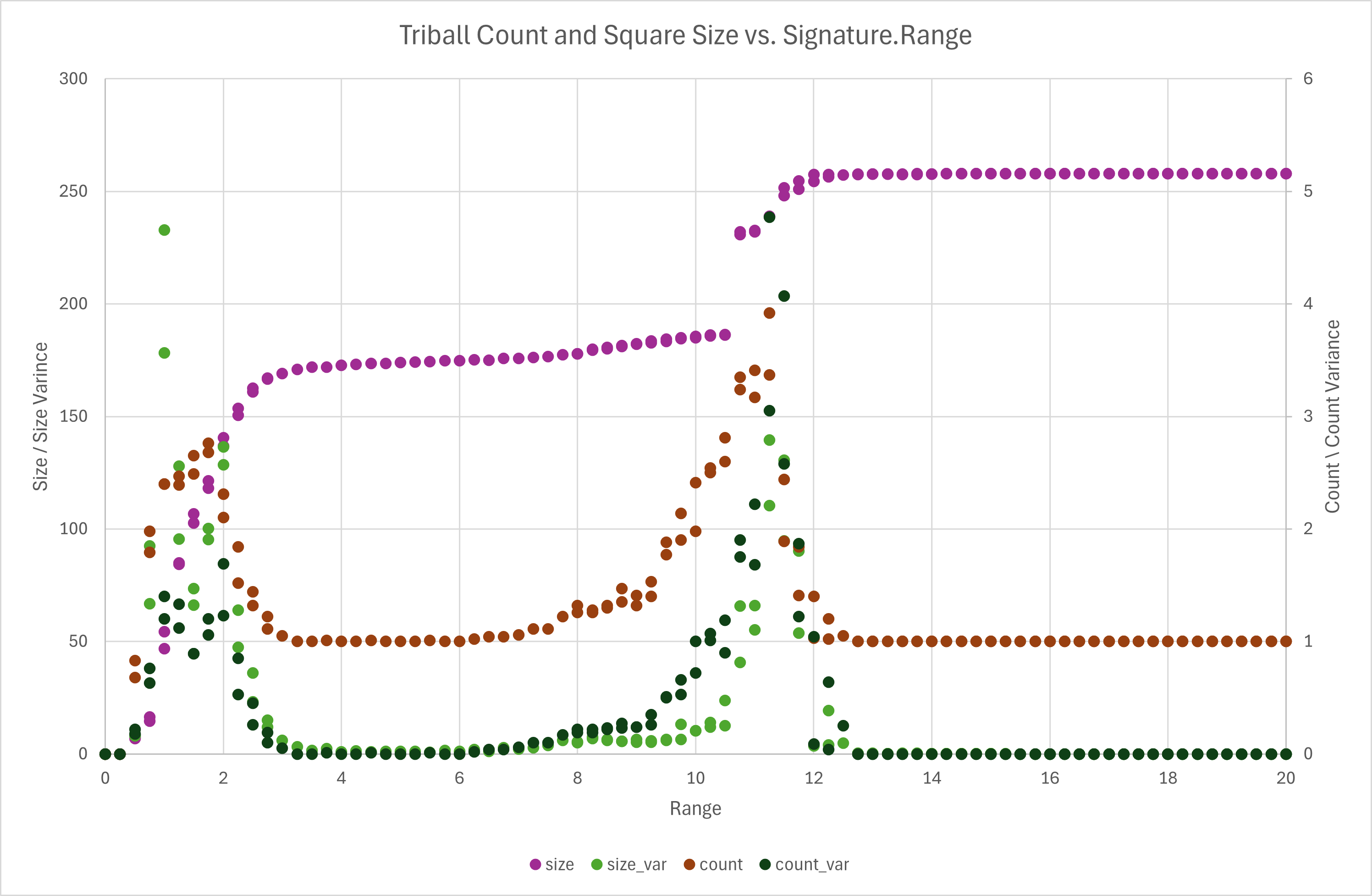

The plot below is what i was looking for which is basically a shmoo plot of detection outputs (ie triball count, x/y, size, etc.) vs. signature (u, v, range values, …).
This particular experiment was just with a single triball in shoddy lighting conditions and varying the signature.range of the green trained signature from 0.0 to 20.0. On the left are the square size of the detected triball and the variance, and the right is the count of the triball(s) and the variance (should only be one triball and variance of 0).
To be useful this would need to be run with no triball as well and a real measurement of the triball size based on camera placement. But at least it shows I’ve got the API calls getting some variation, which is what i wanted.
While chart is not calibrated, one conclusion would be that in current lighting the signature.range I’ve been using (8.0), is in a somewhat noisy section where small changes in the signature.range have a large change in detection quality.
