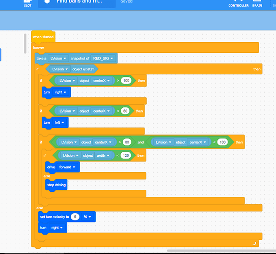

The video you linked was for an IQ robot following a 4 inch ball (or at least, that’s what it looks like), if you are using a V5 robot with the vision sensor mounted higher than it would be on an IQ robot, then I would expect all the numbers for ball location and width to need adjusting accordingly. The general idea of the video was to have the robot turn left or right if the center of the object was not near the center of the image (and the numbers 60 and 100 really don’t make sense, as the center of the image is at 158) and then drive forwards until the ball width reached a certain value.

This is what we have. One time it did follow the ball a bit, but when we came back, we can’t get it to work. We even tried recalibrating it in case lighting is different.
We are using the VexCodePro and planned to convert this to text once we got an understanding of how to make it work since nothing we did seemed to work, we reverted to blocks just to reduce the probability of error

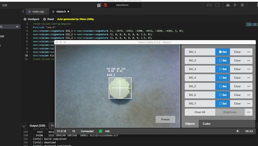

Placing of the vision sensor and its field of view are critical, how you do this will determine the numbers that are needed to be able to follow an object. The robot will only find an object if it is within the field of view, for a V5 clawbot, I might place the vision sensor here (and I’m running the clawbot backwards as the claw gets in the way).
so fairly high and looking towards the floor at an angle. If the code has a different goal, then placement may need to be changed.

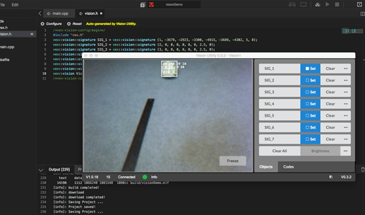

In that position, this is how the vision sensor is seeing the object.
so with the ball centered in the image, it’s about 18 inches away.
the field of view where objects can be detected ranges from about 8 inches.
( 24 inch ruler added for reference)
to about 36 inches.
If the ball goes outside of that range then the vision sensor will not detect it.
As I said in the previous post, center of the field of view is at 158 (the vision sensor image is 316 pixels horizontal by 212 pixels high). With the ball at the closest distance it is about 74 pixels wide (see image above). So with those numbers in mind, the code I threw together to control the robot was along these lines (only part of the code posted)
