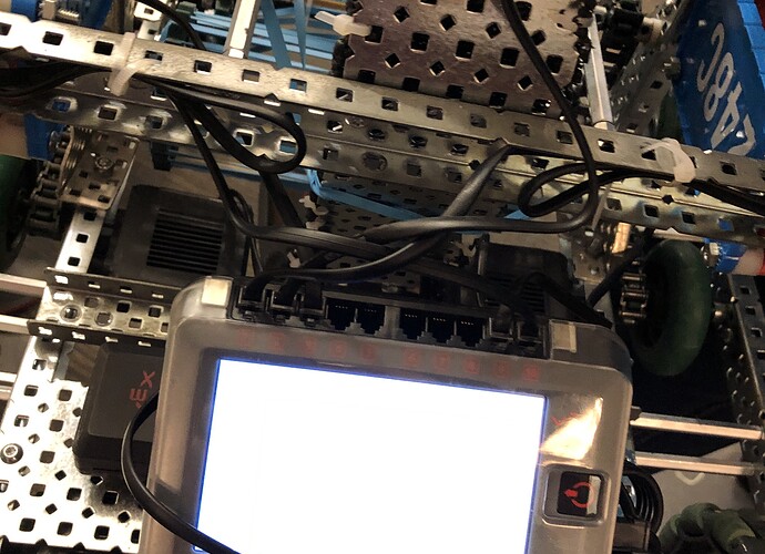

We had one team that repeatedly had the white screen of death at our league night last night. Five matches and they got the WSOD at least 3 times. They said that it was only when the ran the flywheel “a lot” … so they didn’t even run their flywheel in the last match.
Attached is a picture. You can’t even power off the brain … you have to unplug the battery. She said that she tried to plug it into the computer before unplugging the battery (while in the WSOD) and tried to download their program to it (RMS - Python). RMS gave an error (I’ll try to get a picture of the error next time), but it said that it couldn’t be downloaded and gave some error about being overclocked.

No, there will be nothing in the log.
