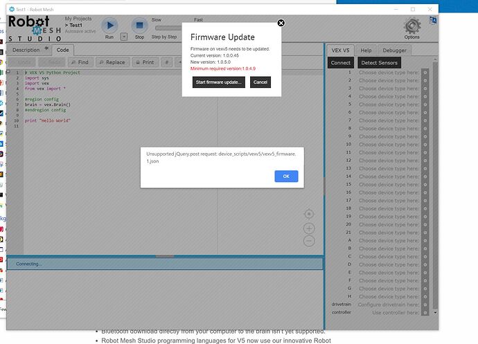

Connected the controller to the PC USB. Controller is paired with the “brain”. Opened the Robotmesh studio (latest download- how do I find the version number?)
Before connect - I have to set the USB Controller port in options
Then after pressing connect I get error - Capture The firmware version shown here is incorrect as verified in vex studio. How can I make the wireless update work?

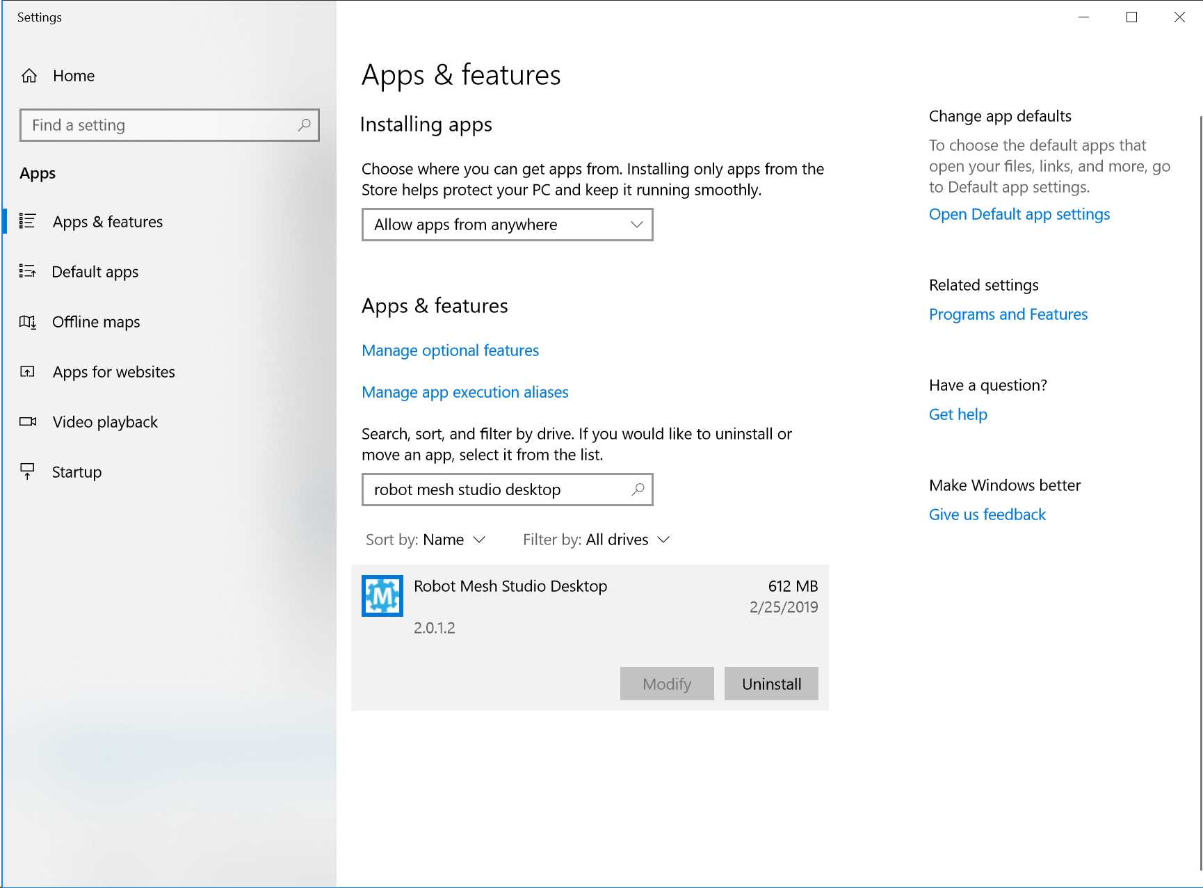

Make sure you are running version 2.0.1.2 of RMS Desktop. You can find the version number in the list of installed programs in Windows. In Win10, open the start menu, search for add or remove programs, open that, search for Robot Mesh Studio Desktop, then click on it. It should show the version number there beneath the program name.
Thanks - that works. I had 2.0.1.1, which has the download issue.
