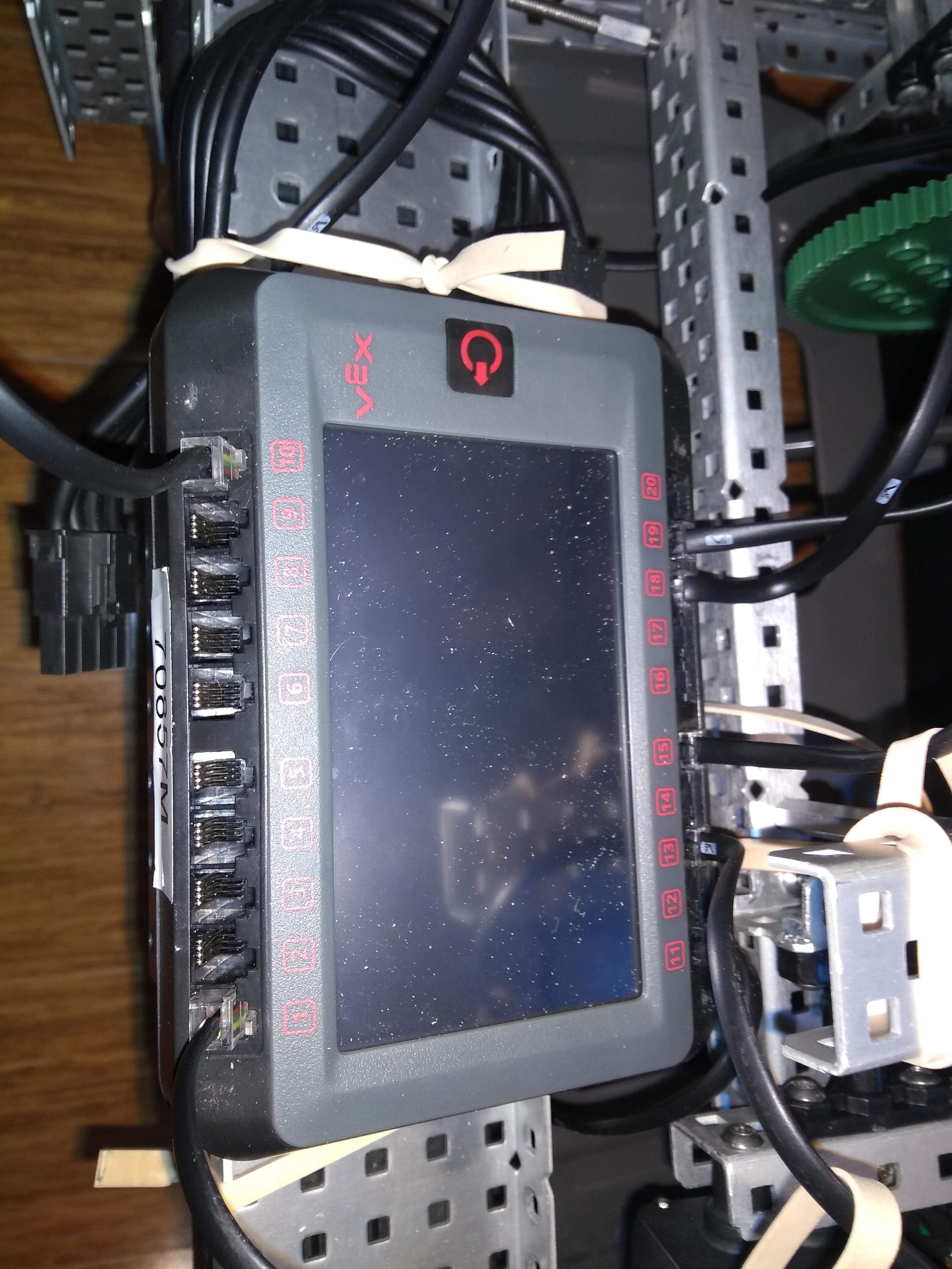

Our issue is with the ports on the “brain” and motors. The cords are so loose that we can’t keep them connected. While they are not actually falling out, they wiggle like a loose tooth. Some appear to not work at all but then will magically connect to a specific motor with a specific cord if you hold it just right. Talk about frustrating! My poor boys spent TWO HOURS trying to get their motors attached tonight and this is the SECOND time we’ve had to do this (a redesign of the bot meant we had to disconnect everything). There’s so much tape and rubber bands holding cords in specific positions that it looks like Frankenstein.

It would be useful to see some photos showing how the cable is connecting to the V5 brain.

Our team has at least one brain (out of five) with similar problems and we had another team at our last event with the same problem as well. No difference between Vex manufactured wires or those created by our team. Our ‘workaround’ for the situation was to ‘wedge’ the end of a zip tie between the wire end connector and the outer wall of the brain port. This was the only way we could get a tight enough connection. I don’t believe that all of our ports on the brain are in this condition- but I believe it’s at least 50% of the ports. We also had a motor with the same problem and rolled a small piece of electrical tape several times and created a ‘wedge’ out of that as well.
Hopefully ‘wedging’ something will help. I will also be contacting Vex about a replacement.

Our wires are inserted like they are supposed to be, with the little VEX clips. But we have to jam other stuff into the spaces around them to get them to stay “connected”. THey do not fall out just don’t register that they are attached. It happens on the motor ports and the brain ports.

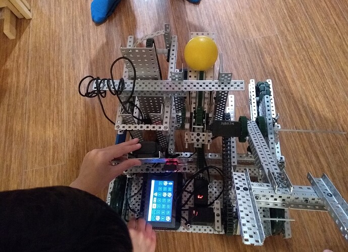

This is our current configuration. Three if the seven motors stay connected without issue. The others, not so much.

We tested one of the motors that we couldn’t get to connect last night and removed from the machine and it appears to be toast. No amount of giggling the wires on either the motor port or brain (even the ports / wires that “always” work) changed anything. :frowning: So now we’re down a motor. sadness…
