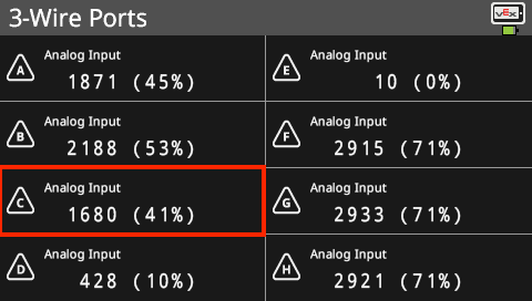

During the ARM Install process Joint 3 continues to fail, the numbers continually rotate from 0 to approx 460 then it starts over. It never gets close to the range. I have changed all wiring several times but the issue repeats itself. Any help out there lol?
Hello @cobra031! It seems it could be a faulty potentiometer. But there’s a way to look into it, from the Devices menu, you can select the 3-wire icon and it will show you all the analog values. My values when I move the arm vary between 90 and 2000. Do yours still stay between 0-460? Do you have an extra pot you could try in its place?
Lauren thanks for the help, ordered new ones and it worked!
Wonderful! Glad to hear it
