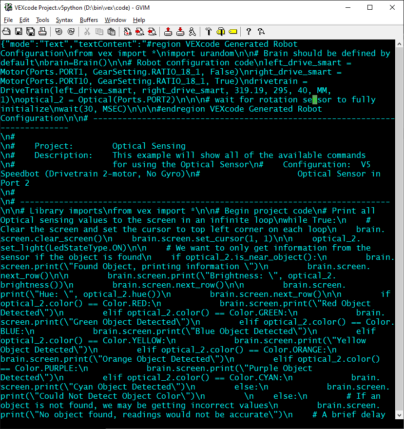

Is there a way to save VEXcode Python text files keeping the program structure? It looks like the .v5python files are wrapped (is it because of the blocks<>text conversion?) and very difficult to share unless you insert them into the application (or the web-based app). Trying to get a Git system going for the teams and while at least these are seen as plain text files so versioning works, they are hard to read/understand by human brains if code viewed in a non-VEXcode environment, basically it looks like this:
EDIT: I suppose one can always scrape the text and paste it into a text editor and save as *.py, but humans don’t have enough discipline for something like that.
By the looks of the code picture, I think the entire file is a JSON encoded file. If you have a generic non-vex Python program that reads a file and then spits out the JSON in the correct format, then it should work.
{“mode”:”text”, “textContent”: content}

Summary: until @jpearman responds, as an unofficial response I do not think there is a program that exists as what I am aware of, but you can code your own
The share button in Python mode exports out a .py file.
Never noticed the Share button, thanks for that.
Went to test and my Share button is grayed for both VEXcode desktop and codev5.vex.com. Not sure what condition needs satisfying for that to function.
Yeah… it’s supposed to work but clearly doesn’t. Looks like the button is disabled incorrectly due to a logic error - we’ll get that fixed for the next update.
@tfriez: Share button now works on codev5.vex.com. You move fast, thank you!
Share button gray again. Can’t figure out what I did and what turns it on/off. Using Chrome on Windoze so all legal and “industry standard” there. Back to copy/paste and saving by hand sigh. Can the process be reversed? In other words can someone code a functioning program then copy and paste it into a text file, then send it to someone else, then that someone else opens fresh Vexcode window (whether desktop or web), plops all the text from the shared text file into the code window and send to brain? Will that work? Will all the port definitions translate? I guess one way to find out is to go and test…
