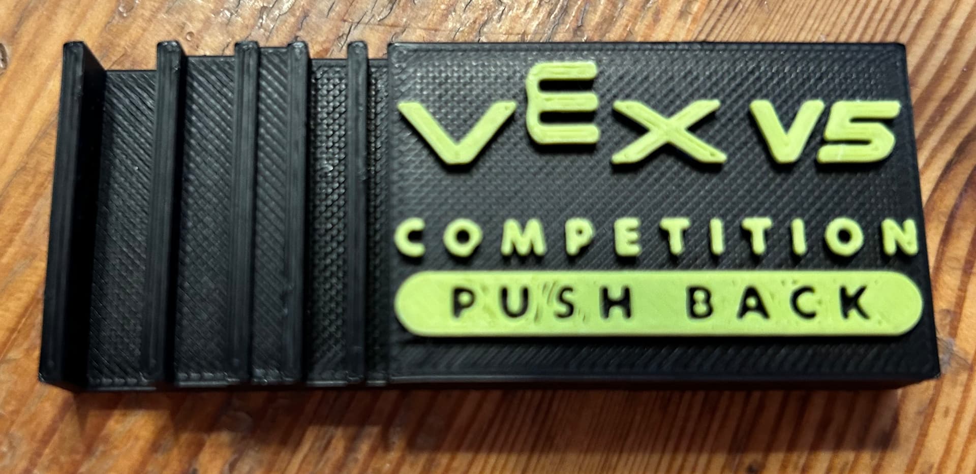

Ok - made a smaller version, and took @sazrocks advice for avoiding elephant foot. Being minimalist - no labeling of each slot - from left to right:
  • String - 0.25"x0.25" slot
  • Zip Tie 11" - 0.1875"x0.055" slot
  • Zip Tie 4" - 0.1"x0.042" slot
  • Double stacked plastic - 0.14"x0.14"
  • Single plastic - 0.07"x0.14"
  • V5RC PU logo :slight_smile:
RefereeTool-Small.stl (4.6 KB)
(blank no logo)
ugh - had wrong depth in model for 11" zip tie, rest ok.
Here is fixed model. length of block 3" - pretty portable.
RefTool-small-fixed.stl (4.6 KB)
Printed it and tested it out, a few items of feedback:
  1. The slots are all a little bit undersized at their narrowest points when printed on my Bambulab P1S. For example I’m measuring 0.067” with my calipers on the single plastic sheet slot and 0.138” for the double stacked slot. I tested a piece of 0.07” plastic I had laying around and this made it fit pretty snugly into the slot rather than fitting in easily. I’d recommend adding a little bit of oversizing, maybe 0.005” or 0.01” to ensure legal items fit their slots.
  2. You can probably get rid of the blank rectangular portion to the side of the slot, it would make the overall footprint smaller and easier to fit inside of robots.
  3. To help identify which slot is which, you can add recessed lettering on the bottom face of the part underneath each slot to label them.
thanks for feedback - minimalist design bring max improvement suggestions. The decorative rectangle could be removed, but my thinking at the time it fits inside my finger grip while checking inside robot. I will experiment a little more.
So, usability, your clearly defined tolerance of ± 0.01 makes sense if pro tool for head referee, but inspectors, I think you want them to hit edge cases and have a strong “this is gray zone”. giving too much wiggle room can lead to false positive by inspector, only to be called out by other teams (we have all been there).
That said, absolutely right - posting before thorough testing of design. I do think transparency is good and pointing out shortfall of tools used for 3D modeling and printing is important.
