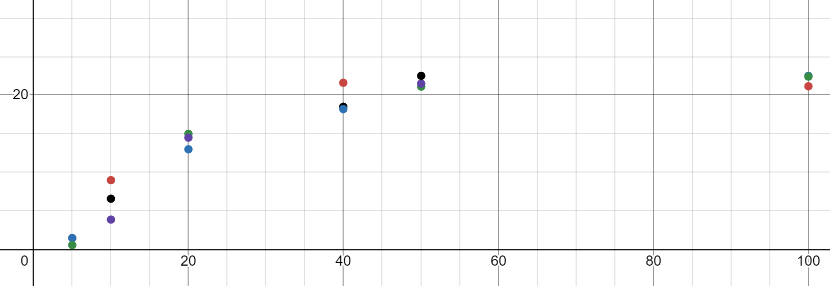

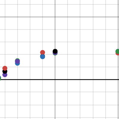

x-axis: frequency of voltage change (hz)
y-axis: power loss (deg drifted when driving straight)
tested on continuous 100 power on left side of drivetrain and alternating 100/99 power on right side of drivetrain

I ran more tests but I recorded with an IMU the end angle. All of these tests were done around 100, 99-100. The goal of this test was to figure out the relationship between update frequency and how much the robot curves. I ran each test 3 times, and all of the data is below.
Control test 1. 100, 100 with 10ms, no power fluctuating. End angles:
0.5, -0.5, 0.1
Control test 2100, 99 with 10ms, no power fluctuating. End angles:
-0.3, -0.7, 0.3
  chassis.drive_brake_set(MOTOR_BRAKE_HOLD);
  int iteration = 0;
  int delay_time = 10;
  int fast = 100;
  for (int i = 0; i < 500; i += delay_time) {
    int pow = (iteration++ % 2 == 0) ? 0 : 1;
    chassis.drive_set(fast, fast - pow);
    pros::delay(delay_time);
  chassis.drive_set(0, 0);
  pros::delay(50);
  printf("%f\n", chassis.drive_imu_get());
The code above was run for every test below, with the only difference being delay_time was changed.
10ms. End angle was:
21.15, 22.5, 22.4
20ms. End angle was:
21.1, 21.5, 22.5
25ms. End angle was:
18.5, 21.6, 18.2
50ms. End angle was:
13.0, 15.0, 14.5
100ms. End angle was:
3.9, 6.6, 9.0
200ms. End angle was:
1.5, 0.6, 1.5
It seems like this is correct. Load changes how this behaves.
