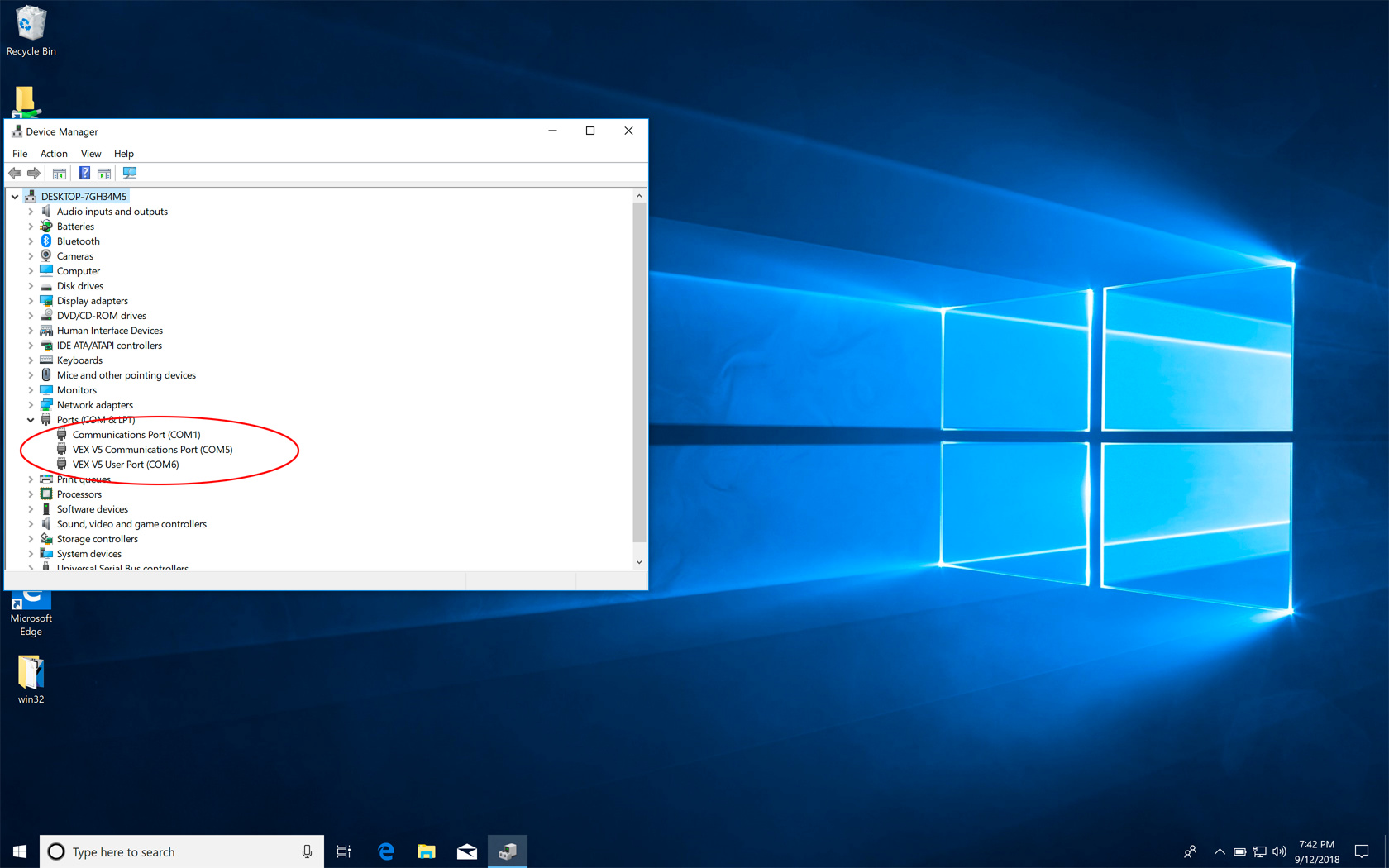

Its a pc, windows 10, version 1803, and the brain is not showing up when plugged into windows at all. It just doesn’t show up when plugged in, robotc had no issues however. Windows doesn’t show it when its plugged in, like it would a flash drive on devices either. Vcs also doesn’t show it in the drop-down menu for selecting which brain you’d download to. However the brain shows itself as plugged in.

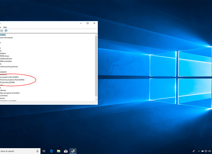

Check the windows device manager, you should see two V5 serial ports, if these are not present or have yellow warning triangles on them, it’s a driver issue, perhaps reinstall VCS if that happens. If that doesn’t help then try using a USB 2.0 hub, if you have one, between the PC and V5.
