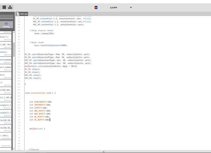

We tried that code and made it work for our robot setup. The robot still did a circle. We tried to reverse the motors and that did nothing. We also replaced the gyro and that did nothing. Thank you for your patience.
I have attached our gyro code as written so far, per your directions. The robot is still just rotating on its central axis (like a top). We have a green light on the Gyro itself. When we go into the brain "devices’ 3-WIRE for the “H” port (which is what the Gyro is plugged into) we see an Analog input of 1847, and a PWM of 255. Not sure if that helps you help us, but thanks for helping. Very frustrating!!
Don’t try to calibrate your gyro in the middle of autonomous. Also, don’t pass arguments to the startCalibration method, as some arguments will change the scaling factor of the gyro.

    Motor1.stop();
Common gyro problems include the gyro not being plugged in all the way, moving the robot before calibration finishes, or turning in the wrong direction. Check for those. Preferably in that order.
