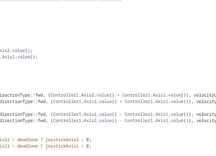

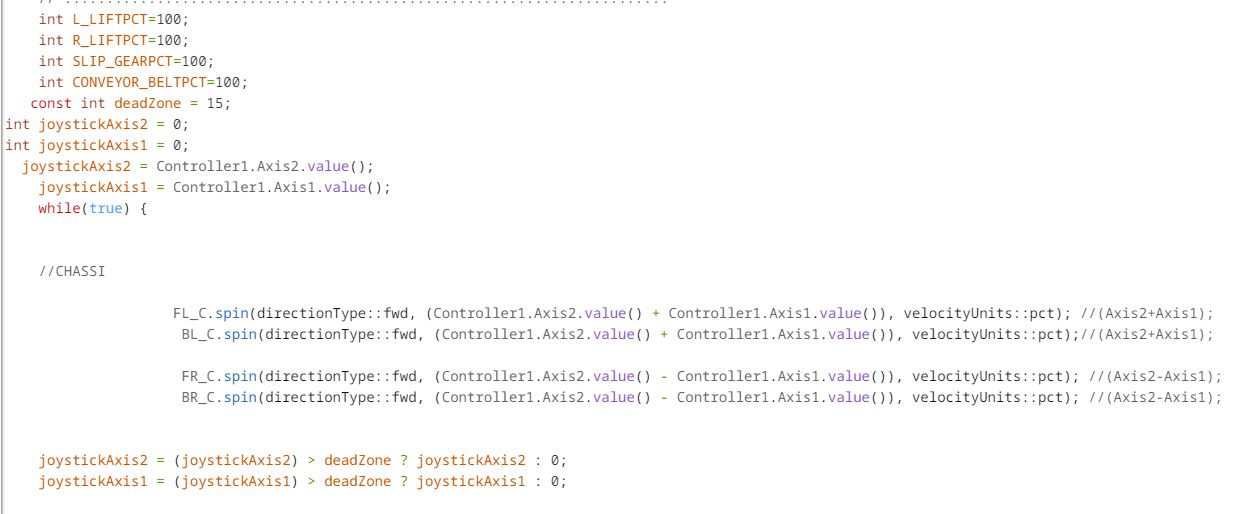

int L_LIFTPCT=100;
int R_LIFTPCT=100;
int SLIP_GEARPCT=100;
int CONVEYOR_BELTPCT=100;
const int deadZone = 15;
int joystickAxis2 = 0;
int joystickAxis1 = 0;
joystickAxis2 = Controller1.Axis2.value();
joystickAxis1 = Controller1.Axis1.value();
while(true) {
//CHASSI
                FL_C.spin(directionType::fwd, (Controller1.Axis2.value() + Controller1.Axis1.value()), velocityUnits::pct); //(Axis2+Axis1);
                 BL_C.spin(directionType::fwd, (Controller1.Axis2.value() + Controller1.Axis1.value()), velocityUnits::pct);//(Axis2+Axis1);
                 FR_C.spin(directionType::fwd, (Controller1.Axis2.value() - Controller1.Axis1.value()), velocityUnits::pct); //(Axis2-Axis1);
                 BR_C.spin(directionType::fwd, (Controller1.Axis2.value() - Controller1.Axis1.value()), velocityUnits::pct); //(Axis2-Axis1);
joystickAxis2 = (joystickAxis2) > deadZone ? joystickAxis2 : 0;
joystickAxis1 = (joystickAxis1) > deadZone ? joystickAxis1 : 0;<br>![Capture.JPG|690x500](upload://irUEtMctVs1Mv4cbdzpd1OUHTkj.jpeg)
#11
We are still having problems with creeping. It creeps forward but not backwards. Any help will be appreciated
#12
The problem is that your program only pretends to set a dead zone. It doesn’t really set one, though. You just plug the joystick values directly into the motor.spin commands, regardless of them exceeding the dead zone.
As for actually dealing with the dead zone, there are several other problems. First, you only set joystickAxis1 and joystickAxis2 a single time since it was done prior to the while loop. Then you compare them to the dead zone, but you do so without an absolute value. Of course, since you don’t do anything with these it doesn’t really matter. What you want is roughly the following:
while(true) {
   now check their absolute values against the dead zone size and set them to 0 or not.
   FL_C.spin(directionType::fwd,joystickAxis1+joystickAxis2, velocityUnits::pct);
   repeat for the other motor.spin commands
