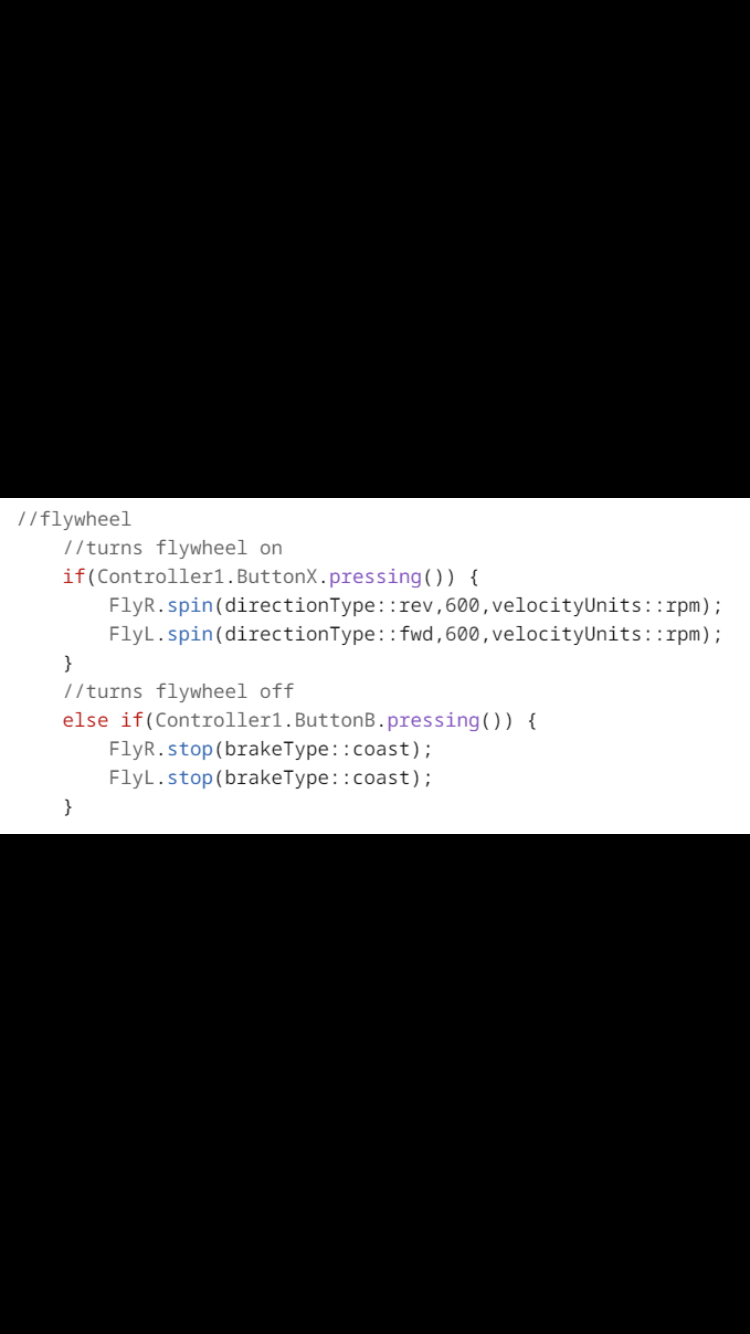

I am new to programming and I am wondering if in VCS you can make a motor turn on and off at the press of a button. what I mean is if you press L1, one time and release it, could you make it stay on until you hit the button again? any and all help will be greatly appreciated!
Team 373A
I’m not exactly sure how to do it with a single button, but last year my team did that with our flywheel with two buttons as shown. Btw, our teams programmer had zero experience so I’m unsure how good it is. Hopefully this helps. image

It is different than what the others shared. What you originally asked was press a button to turn the motor on, then press it again to turn it off. What @jpearman shared was one button for on, and a different one for off. What I shared would accomplish what you originally asked.
