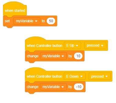

Actually, it’s this but instead of the my variable bit, you put the block “Set velocity of (motor number / motor group) to (velocity percentage)” I can’t actually show this in an image as I don’t have access to my program software at this moment, but I believe the block for this is light blue.

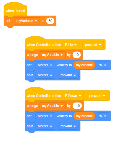

Yes, you would then need to set the motor, like this:
But it’s helpful to store the percentage in a separate variable to manipulate it.
