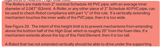

Rule SG5 states “Any extensions or combinations of extensions above 18” must fit within a vertical cylinder 2” in diameter.”
Our team has no pneumatics so we plan on using our flywheel to shoot a bunch of small gears (1.75 inch dia) with string attached. Basically, we will be using gears as ammo and we want to build like a magazine of them so we can aim before every string shot. BUT, the gears are going over the vertical ceiling when we launch them cuz of the angle
Does the rule mean that all of the gears must initially be contained in a cylinder 2 inch wide? (like a pringles can)
Or can the gears just be stored however we want?
Also, if that is allowed, why hasn’t someone built a blocking wall yet? Can my team make a wall that initially fits within 2’’ radius cylinder but expands up and out past the 2’’ width to block other peoples’ string shooters?

Sry I should have been more clear, I meant shooting string for horizontal expansion, but the flywheel is angled upwards, so we are considering the possibility that the gears might go over the vertical ceiling.
Since our gears are kinda going over the vertical ceiling when launches out, do they have to be stored in a 2’’ cylinder volume on our robot? ( The gears themself can fit, just we don’t want to build a tube to contain them)
I think the rule is that they have to be able to theoretically be able to fit in the 2" cylinder volume.
In other words, you should have the ability to fit it into the 2" cylinder volume, but it doesn’t have to be stored in a 2" cylinder.
Be mindful of the recent Q&A - the volume must be perpendicular to the floor tiles. Referees can check by using a 2" PVC pipe (specification somewhere …)
There is no vertical expansion limit in the endgame.
the game manual suggests using one of the roller pvc pipes as a way to check, giving the specifications of
Oh well, this kind of solves the whole issue, doesn’t it?
so that means we DONT have to worry about this whole 2’’ cylinder thing to store our gears?
Correct, unless you are trying to do something before the last 10 seconds.
