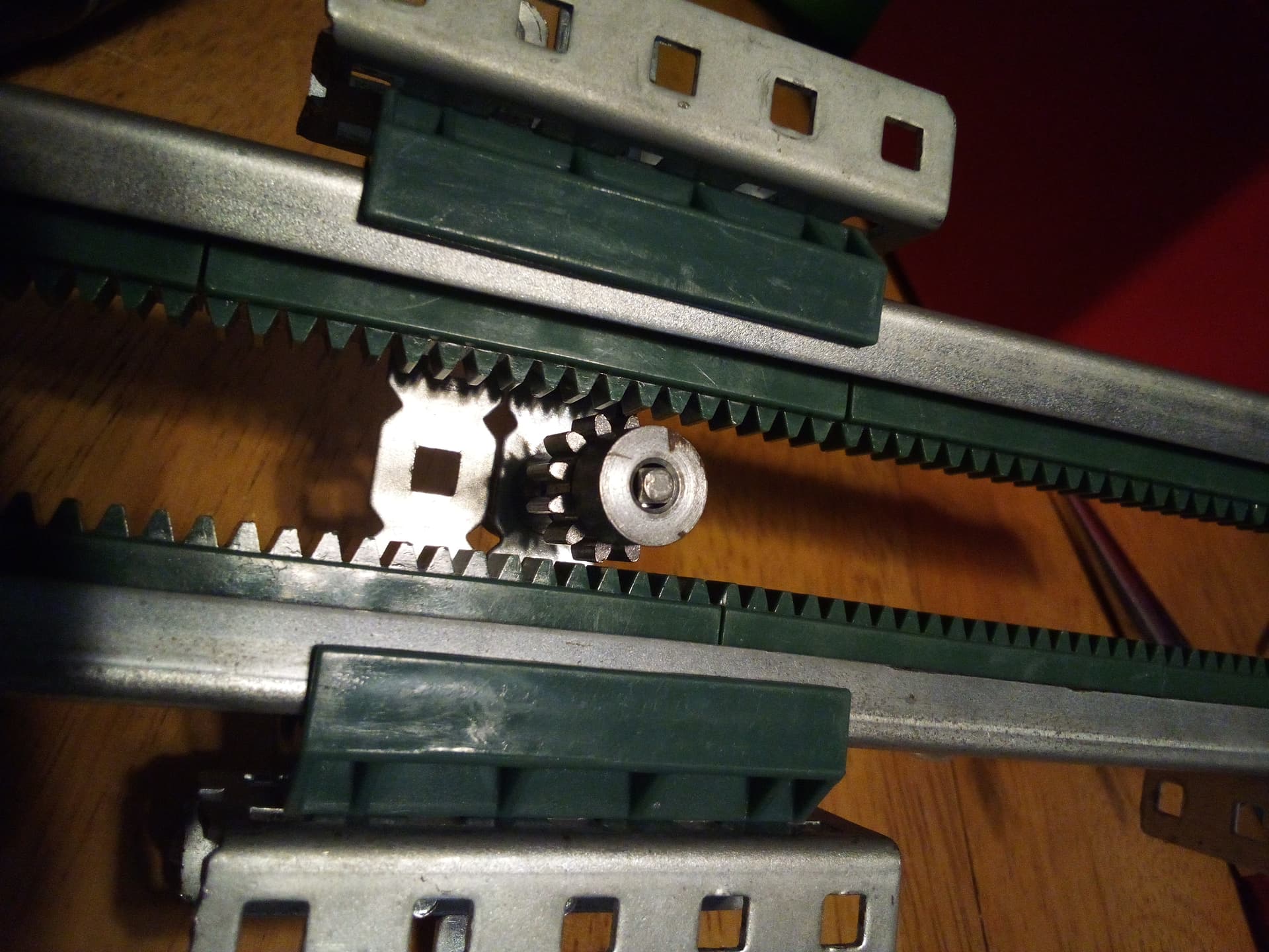

I have a vertical lift that I thought would work well for ellivation but the gear isn’t lining up right now mater how many different ways (that I could think of) to fix it
Use spacers between the outer track and the c-channel on both sides so its even.
I had this when making mine the way i did it was long screws then spacers just before the green holder that way it pushes it out into the gear i can get a photo tommorow if you need
What size of spacer would you suggest, or should I just experiment with what whatever works for me?
I want them to move opposite directions.
Just experement it depends what size screw you use. if you get stuck let me know and ill post a photo to help.
