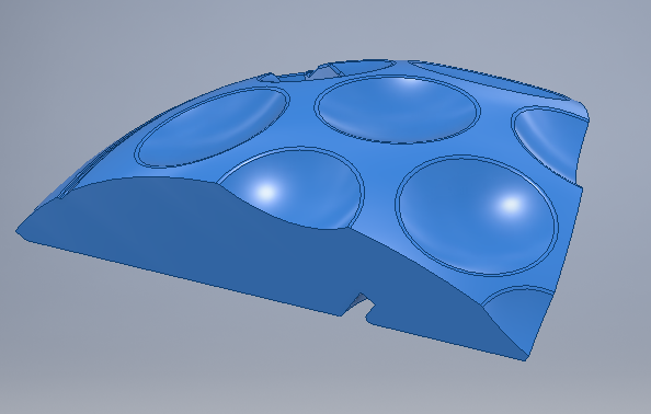

“Ball_Simp_Tenth” is optimized for rapid 3d printing and can be printed without support. Ten of these must be printed for a full Change Up Ball. It uses two Ball_Simp_Ring to engage all the pieces in each half of the assembled ball. Five 8-32x1.5" screws and nuts are also required to join the two halves.
CaptureA
Ball_Simp_Tenth

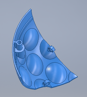

“Ball_Acu_Tenth” can be used to assemble a ball of approximately the same weight as the actual competition ball (it will be approximately 2g over). It will require supports and a longer printing time. Nylon screws and nuts must be used in order to get the weight to be accurate. (Five 8-32x1.5" and ten 8-32x.5" screws for a full ball)
CaptureB
Ball_Acu_Tenth

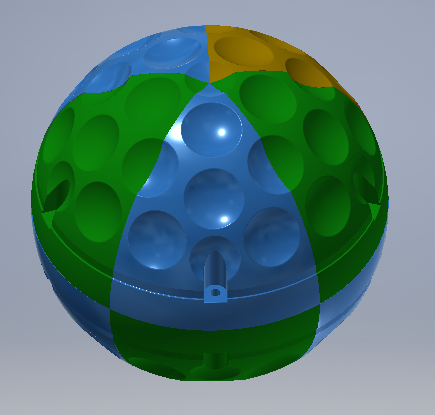

CaptureC
Assembled Ball

Have you actually made one yet? The nylon screws worry me a bit about the structure. Do you think it’d handle any abuse?
I have not printed it myself because I have no use for the balls.
If weight is not a concern then regular screws and nuts can be used but it will be between 30 to 40g heavier.
However, it is a thin shell, an impact strong enough to break the nylon screws would likely also be strong enough to damage the structure of the printed ball. I do not suggest launching this ball with a puncher or across the field with a flywheel.
I assume teams would be mainly using this ball early season when prototyping intakes and other low force applications.
