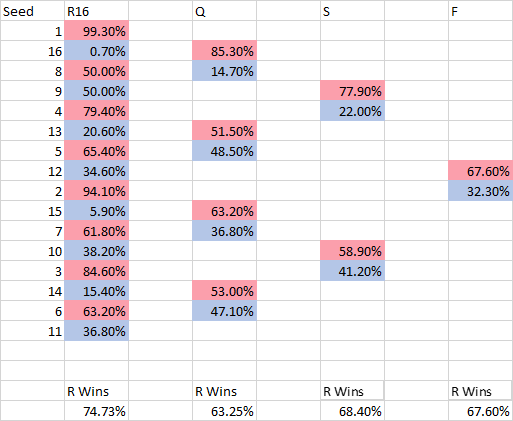

Locally, I have each round broken down by seed (though it simply assumes the higher seed advances from the QF to SF to F…e.g. I don’t show cases where the 4-seed makes the finals) for each of these years. The win-rates of 1v8, 2v7, 1v4, etc. do not change significantly year-over-year. There is some small variance, as one might expect.
For comparison to other sporting events, here is the stats from college basketball converted to red wins %. The data is from here. When coaching I liked to complain that there were never enough qual matches to sort teams properly. But it does appear that on the EP side we run enough to be as good as college BB rankings.
In md table format:
Seed R16 Q S F
1 99.30%
16 0.70% 85.30%
8 50.00% 14.70%
9 50.00% 77.90%
4 79.40% 22.00%
13 20.60% 51.50%
5 65.40% 48.50%
12 34.60% 67.60%
2 94.10% 32.30%
15 5.90% 63.20%
7 61.80% 36.80%
10 38.20% 58.90%
3 84.60% 41.20%
14 15.40% 53.00%
6 63.20% 47.10%
11 36.80%
R Wins		R Wins		R Wins		R Wins
74.73%		63.25%		68.40%		67.60%
