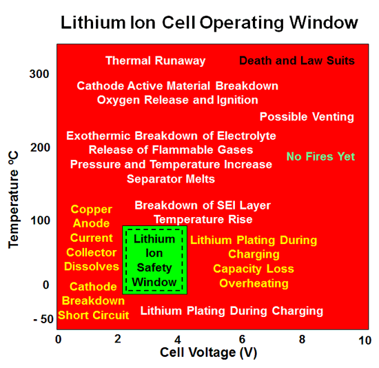

This may not apply perfectly here, but this i think this image pretty well shows how dangerous batteries can be if you use them wrong.
