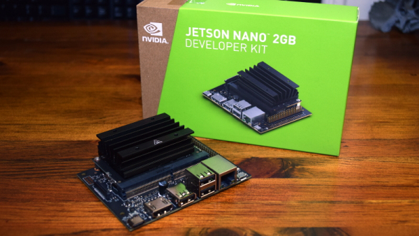

You might be interested in this:
On sale at the end of the month. For roboteers that have limited cash, may be the way to jump in. I think that I’d spend the extra $40 to get the extra memory. YMMV
Edited to add:
There is this hacker news thread that has some pros and cons about this board. Nvidia announces Jetson Nano 2GB, a single board computer | Hacker News
And no, this unit will NOT be VEXAI capable under the current rules…
