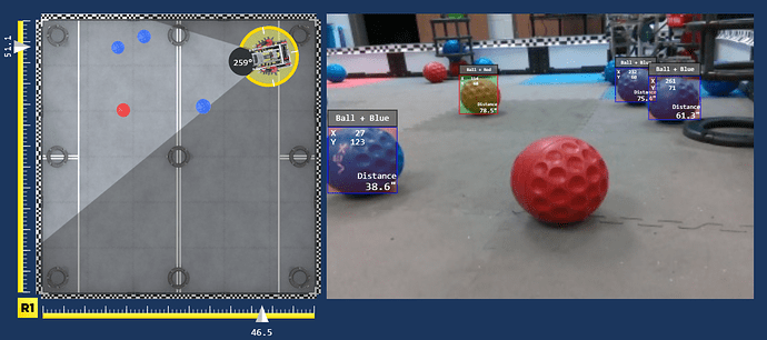

When I look at the dashboard from the jetson wifi, it shows the ball locations and basically says “I see you, you exist,” but when I look at the brain, it says that the boxnum variable is zero (no objects detected) and is basically saying, “I don’t see anything,” even though it can obviously see since it showed it on the dashboard. Does anyone know why this is? Why it’s contradicting itself? Pls help. Thanks20210310_085458 Capture

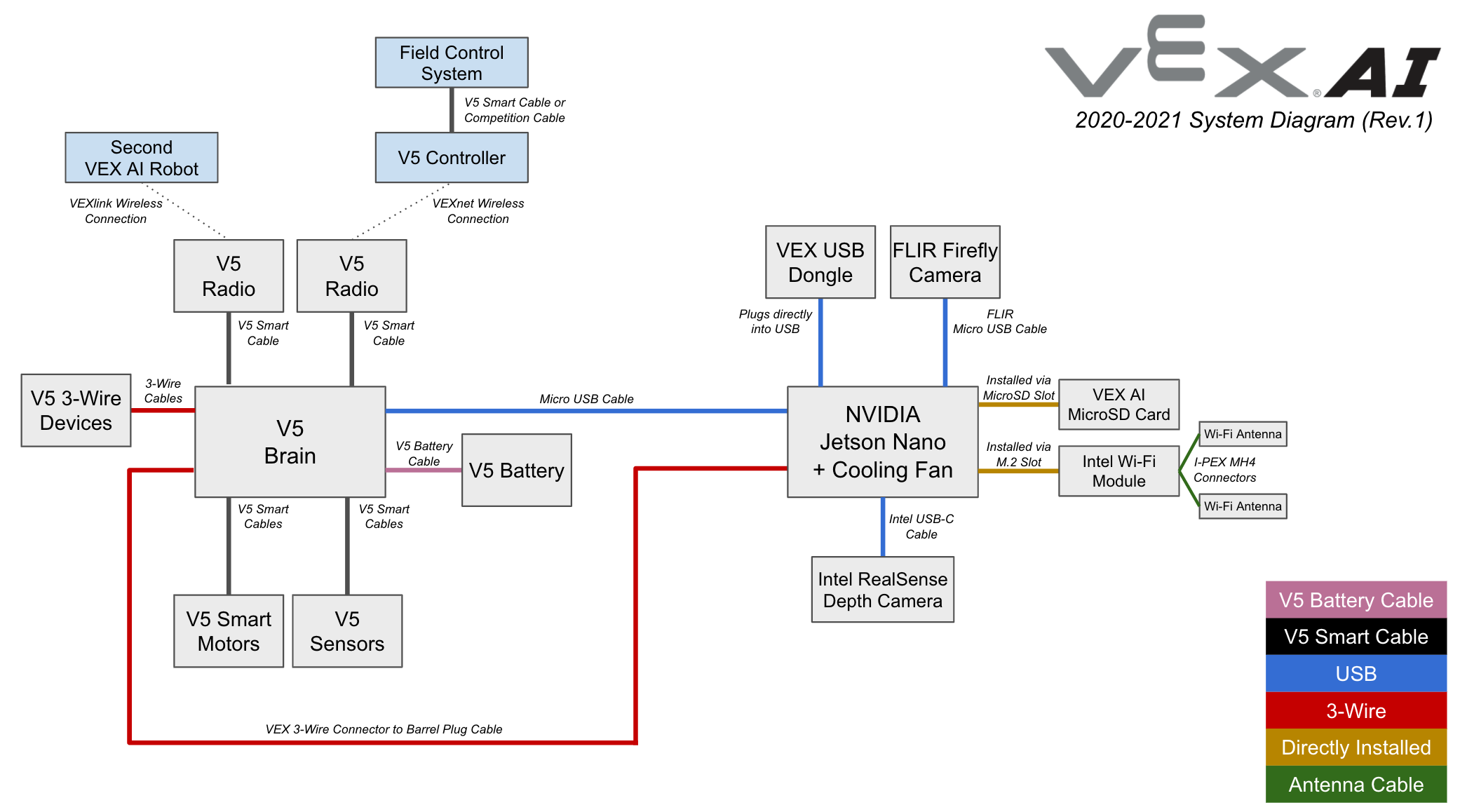

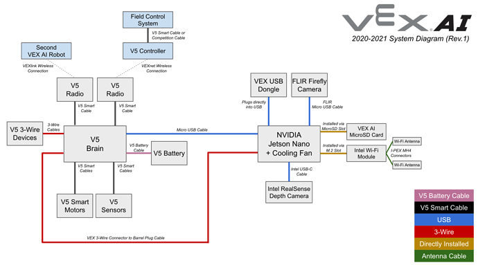

It seems like the jetson isn’t able to communicate with the V5 brain. Do you have the USB cable connecting the brain and the jetson? Here’s an image showing how everything in the VAIC system should be connected together:
