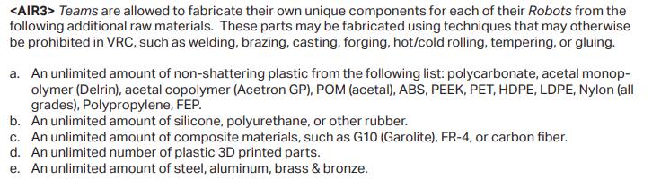

As for parts, the rules are similar to VEX U. Here’s a snippet from the Change Up manual’s AI appendix explaining what we’re allowed to use:
Screenshot from 2020-09-22 21-52-42

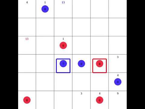

Following up, this is a video of the AI work I did for the fully autonomous robot I was working on for ITZ. You can see I ran the AI code in a simplified model of the world where I could search for strategies much more efficiently.
I like to think of these AI’s as like a drive coach, they should tell you high level things and trust you know how to drive your robot.
  • The number on a tile is how many cones are there. Past “get cone in that tile” its not really worth planning at a high level.
  • The bottom left 4 tiles are where you can place mobile goals for points for red, top right for blue.
  • The red 13 and blue 13 are cones that only those color robots can pick up. They are from the loading station but the only important detail for the AI is that they are red exclusive cones.
  • The big circles are mobile goals, the number on them is cones stacked on top.
The cool thing about building a little game engine like this is I can both test different AI’s against each other and simulate games if I want to do a machine learning approach.
