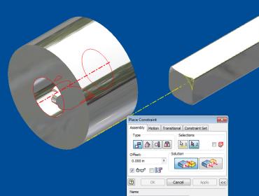

I was wondering If anyone knows how to mate axle collar to a axle?
Constrain the axis of the shaft with the axis of the shaft collar. You will need to zoom in on the end of the shaft to be able to select it’s axis.
first constraint selection.
https://vexforum.com/attachment.php?attachmentid=4852&stc=1&d=1322422363
second constraint
https://vexforum.com/attachment.php?attachmentid=4855&stc=1&d=1322422411
done.
@jpearman. Got it! Thanks for your help!
What jpearman described keeps the axle in line with the collar, but if you want them to rotate together, you’ll have to do a rotational constraint (in the same window as the regular constraints, just a different tab). If you want the collar to be a fixed distance from the end of the axle, set a constraint between a point on the collar (probably the middle of the hole on one of the side faces) and the axle (probably the end), then make an offset.
