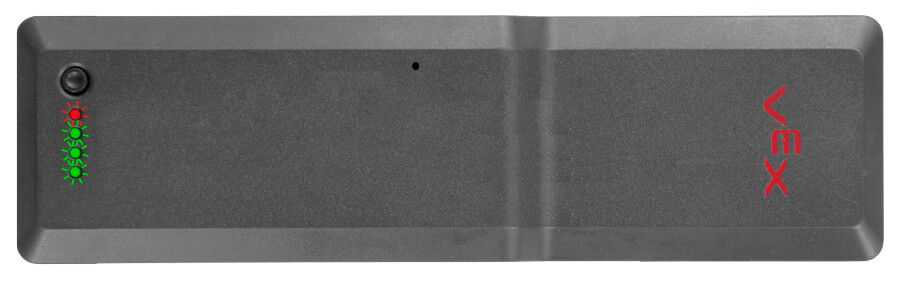

I am from 917X Aviation Nerds, based in Washington. We were just in a competition in Delta, BC, Canada (Double-Barreled Dust Up Space Cowboy Rodeo) where we lost Semi Finals due to an issue with the Battery. We had a voltage issue in the battery, where despite showing 4 green lights at the start of the match, mid match we lost connection with the bot as it showed 3 green lights and one red, a common error with the VEX batteries. This issue was not ruled as a replay, punishing us for a problem with VEX and not us. We believe that this should be a ruling that is changed in the rulebook, ensuring no other team is punished unjustly

How can you say this is a failure of the robot when a new battery, bought just about a week before the competition fails to provide us power to our bot. The battery had shown 4 bars, but ended by showing us 3 green and one red, a common problem with the batteries. It is not a problem with our robot that a brand new battery did not function properly. I am not blaming vex for this issue, but rather urging them to allow this as a cause for replay
can you identify which LED pattern you saw from this kb article.
I can’t think of anything where the battery firmware shows 3 green and 1 red LED at the same time.
It’s not a common problem as far as I’m aware.

Hello,
It seemed to be the error in the following picture. Rather than flashing, it was simply displaying this for a large period of time. Looking back into this website you have provided, I myself am now confused regarding this problem:
