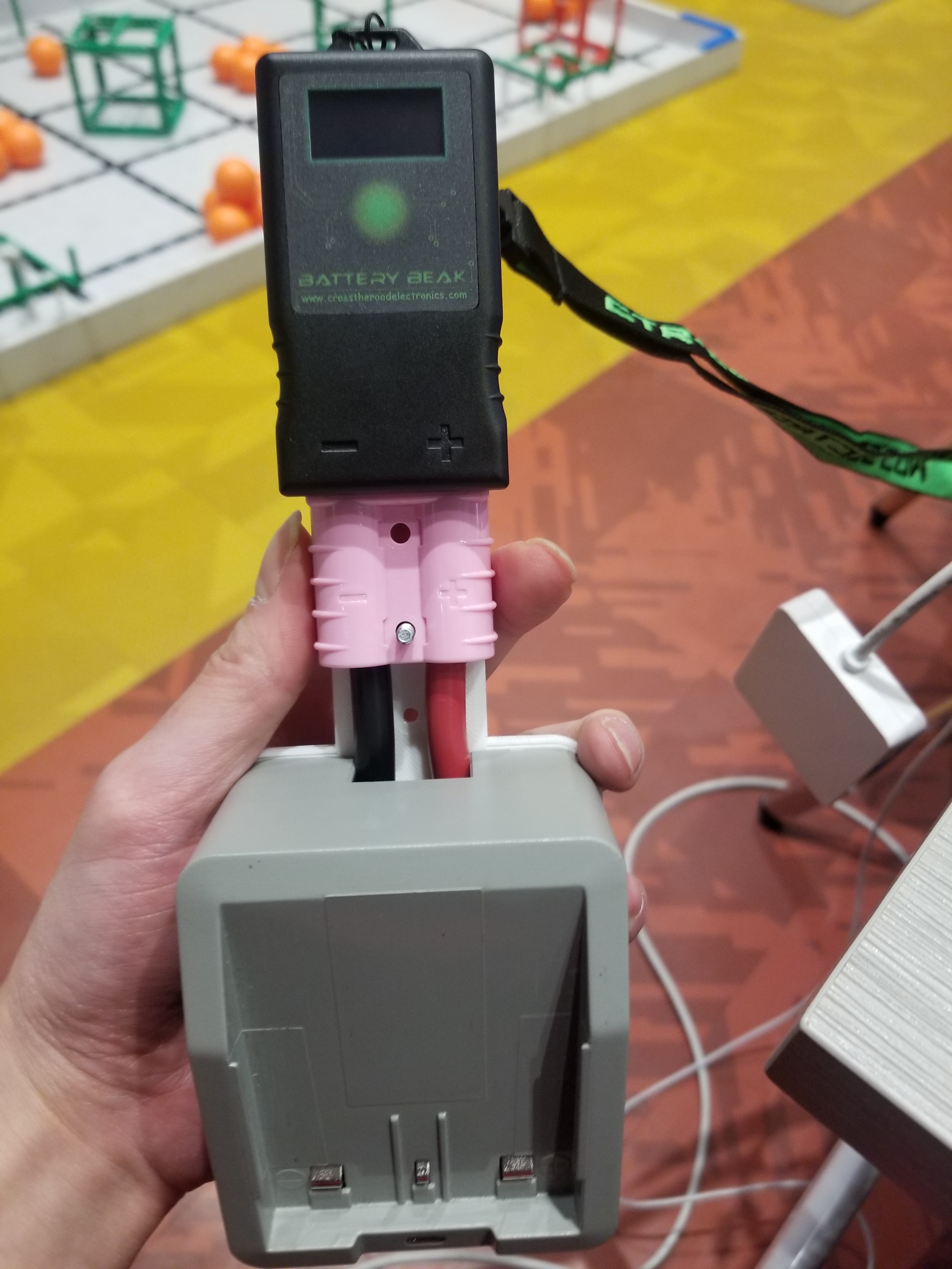

Battery percentage should be displayed on the screen. If you are looking to test your batteries, we use the FRC Battery beak and made a connector that we attached to a VEX IQ battery charger to be able to test our batteries off to the side.
Battery Beak:
Care to share more details about the connector you created?
Here is an image of the tester:
20200129_204203
Thanks very much! I think I will create one myself.
