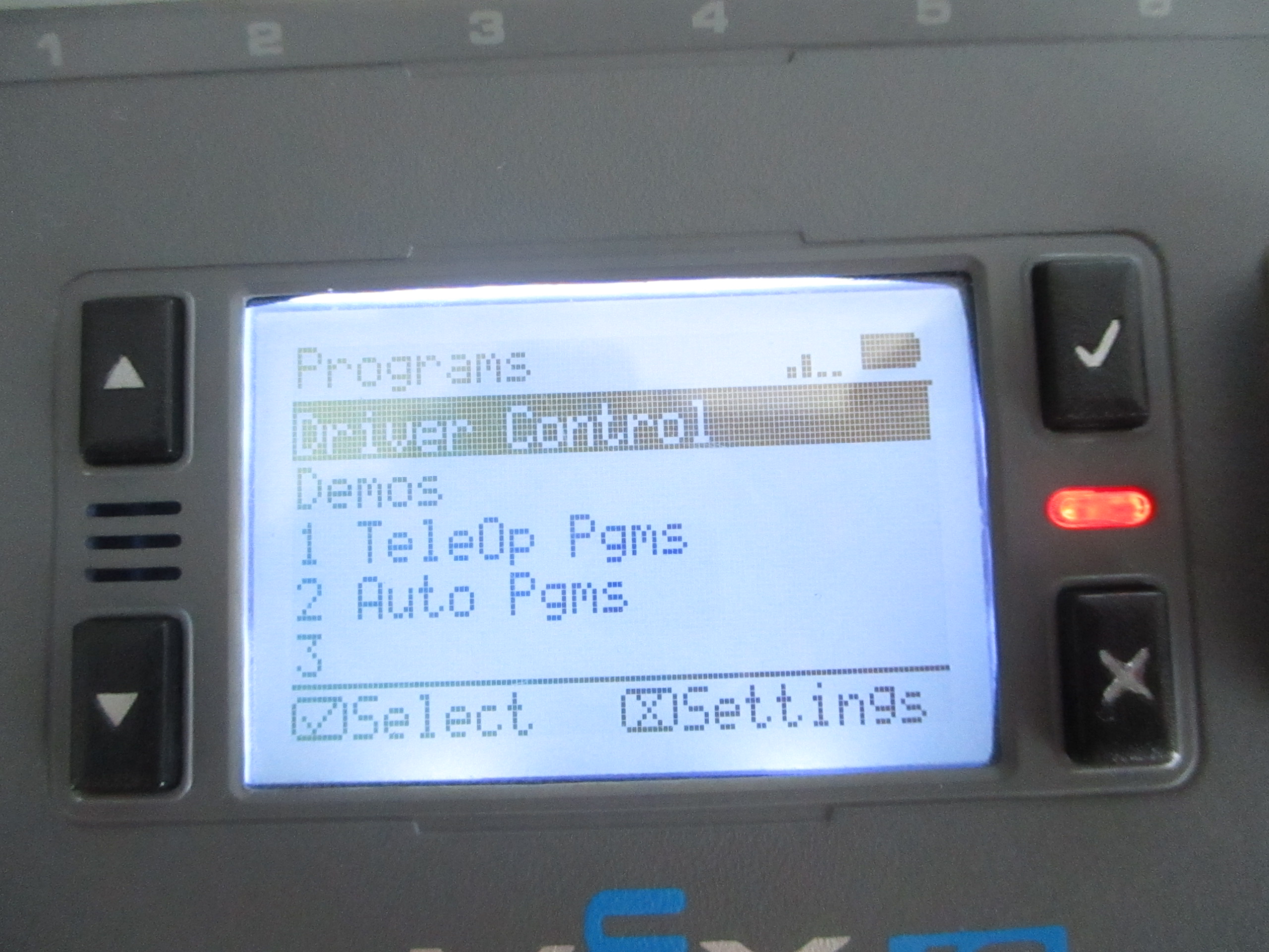

Hello! The problem I am having is that when I take a fresh battery off the charger and put it in my robot. Then I drive it for a few minutes then the brain starts blinking red when it says the battery is still full.

Try another battery, if not that it could be that the battery is overheated
If your motors are under too much stress, it can cause the battery voltage to drop, causing the brain to think that the battery is low and turn the green light red. To solve this, try gearing down your motors (particularly the ones under the highest load, e.g. the drivetrain).
Also, batteries don’t last forever, so if it is an old battery, you might just want to get a new one. But if this was the case I’m pretty sure the battery icon on the brain would not be full, so I’d try what I mentioned above.
The voltage of all batteries drops under a given load. Larger loads cause the battery voltage to drop further. Usually as soon as this load is removed from the battery, the battery voltage will bounce back to near what it was before (minus the slightly lost capacity). Older batteries cannot handle large loads as well as well as newer batteries.
The Robot Brain LED color is “latching”, and tied to battery voltage. The icon on the Robot Brain LCD screen is the instantaneous voltage.
What this means is that if at any point the voltage of the battery drops into the red (dead) zone, the LED will remain that color until it is powered off, but the Robot Brain LCD Screen will always show the current voltage level. So if the battery was highly loaded, but then stopped, the LED can switch to red, while the LCD screen afterwards shows it’s still “fully charged”.

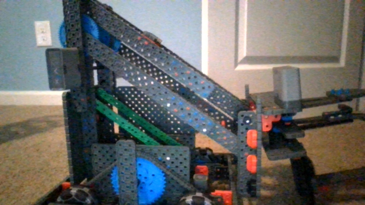

I bought all my batterys last year so I do not think that is the issue. So I have a 40:16 sproket ratio. For the arm it is a two motered arm and it is 60:12. Then for the claw it is a one moter powered arm and has a ratio of 36:12. It was working great for 1 week till I had to fix something on the robot and today I finished all the upgrades and the robot decided to show the red light. Tryed all my batterys and my others brains and it is not working. It was going to be a robot reveal on youtube and now this battery issue I do not have an idea of how to do the reveal. Heres a picture of the side
Sorry if it looks little wonky. I removed the bar for the arm.
Your arm gear ratio looks good, but I think your drive gear ratio is a little extreme. I think that you are overloading the drive motors. I think that you’d probably want something like 3:2 gear ratio (24 tooth sprocket to a 16 tooth). I would recommend trying different drive gear ratios and seeing what works.
your drive ration at least in my experience is perfect. your arm ration of 5:1 sounds a little small and might cause strain on the motors which would help explain the battery issues. im running a 7.5:1 which still might be a little light. i’ve senn most ppl run a 9:1.
In my experience, I have never had a 5:2 gear ratio work for a drivetrain. That’s a 60 tooth gear to a 16 tooth gear, more aggressive than a 2:1 gear ratio. Can you send a video of this working because when I tried it, the motors were overloaded by a lot. They are even a bit past their limit with the 2:1 ratio that I am running, which is the most aggressive gear ratio I’d consider doing for a drivetrain.
As for the arm, 1:5 has worked for me considering that I rubber band the arm. Depending on your arm length, whether you are doing an active of passive claw, and the load that will be on the claw, different gear ratios will be appropriate. If you were climbing like in Next Level, an arm geared slower was necessary, but for carrying two risers with two motors, I have found a 1:5 to be adequate.
Out of curiosity, I’d like to see how your robot performs so I could see what you do to make these gear ratios work. You can see how my robot performs with the ratios I mentioned in any of my Razorbill videos. I am not trying to be rude, but just trying to understand how these gear ratios work for you.
ok. so my robot is the same desighn as razorbill but it is wider and i do run a 2.5 :1. VEX IQ 2019-2020 VIQC Squared Away 154points - YouTube here is a video of 2 robots runnoing a 2.5:1. here is a picture of the from that same robot in those videos. this is neither my robot or my cad files. but i use a pretty much identical gear set up on mine.
