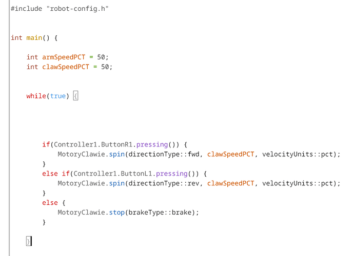

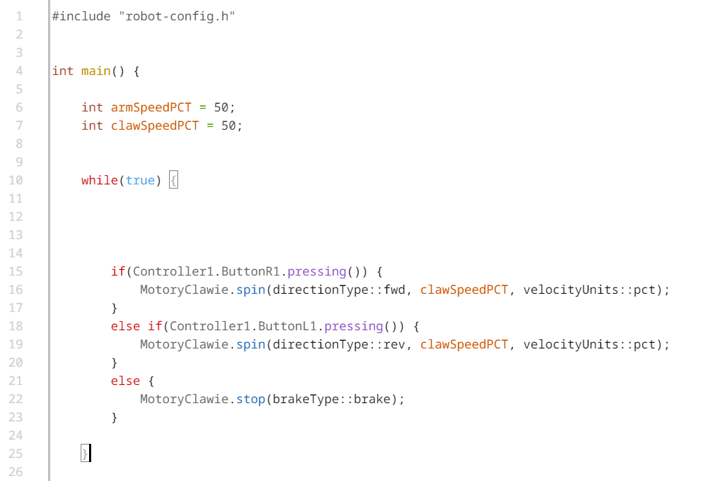

So basically I started coding my robot, (C++, VCS) and then downloaded it onto my robot. The tank control worked fine, but the buttons ( L1 and R1) when pressed, wouldn’t do anything. I was wondering why. Below is a picture of my code. Thanks for any help!
Where are all the vex:: parts? Have you locally redefined all those things that had been defined elsewhere? Most likely you haven’t, and the program doesn’t know where to find things like velocityUnits::pct. Try vex::velocityUnits::pct, for example. You have a whole bunch of those to fix.

So, since “using namespace vex;” is included, ignore my first post. Those parts aren’t a problem. I’m not seeing what’s wrong with the code, though. @7517j , have you tried it with just the code you sent? Was the tank control part removed to post that part? There could be something between the two, like the while loop ending after tank control and before the button presses. Have you double-checked the port for the motor to make sure it matches where the code things it is?

I personally suspect the motors may be not be in the right ports or something like that. That’s why I asked about the code running as is v. with the other parts mentioned and asked if the motor port had been double checked.
