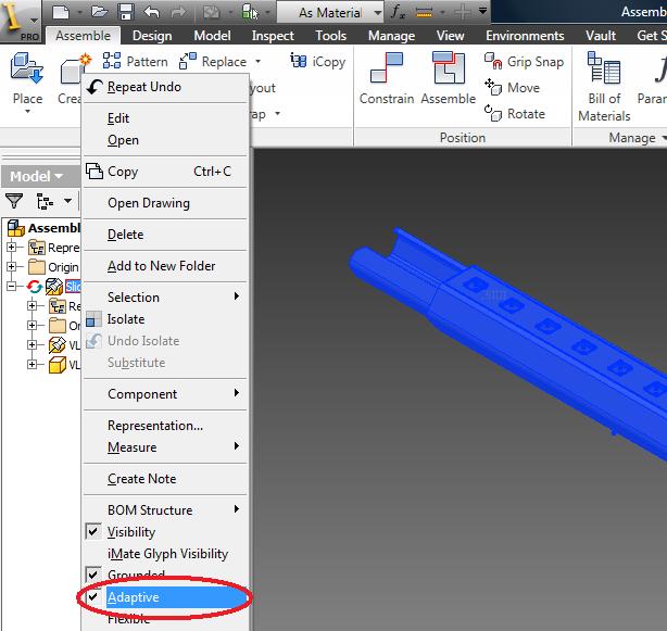

Back to the point, is there any way to modify the Linear Slide in Inventor so that the two parts can move independantly from another? I’m creating a hanging mechanism to check out the size and parts needed and I have an idea which should save alot of space.

Attached is a slide assembly (in a zip archive) I’ve made that allows the two slides to move independently. Place the file “slides.iam” in your assembly, and set it to “Adaptive.” (In the Model pane, right-click on it and select “Adaptive”)
[ATTACH]3682[/ATTACH]
ForVEXUnreal.zip (1.78 MB)
