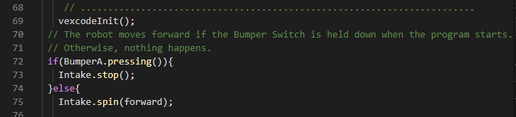

If you are running a limit switch, you can use this code. In this case, I just use it for a bumper sensor.
