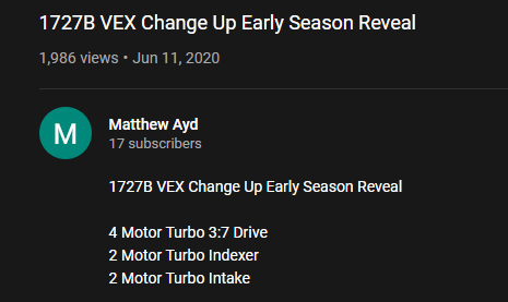

Hello Vex Forum, I am getting vex materials to build a vex robot over the summer and I wanted to build some sort of launcher robot. However, I really wanted to use the intake system and launcher mechanism from 1727b. So, I was wondering if anybody has any specs for any mechanism of a launcher robot. Anything helps. If you can help me with telling me the specs of the base, intake system, launcher, or any other mechanism you are probably saving me hours of designing, building, and coding the robot.
